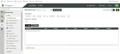

Couldn't view any of the logs (Application Log/Script Log etc.,) from 'Monitoring' screen after Upgrading Thingworx-Platform-Postgres from 8.5.3 to 8.5.19.

14:01:46,721 |-ERROR in ch.qos.logback.core.joran.action.AppenderRefAction - Could not find an appender named [ASYNC_APPENDER_COMMUNICATION]. Did you define it below instead of above in the configuration file?
14:01:46,721 |-ERROR in ch.qos.logback.core.joran.action.AppenderRefAction - See http://logback.qos.ch/codes.html#appender_order for more details.
14:01:46,729 |-ERROR in ch.qos.logback.core.joran.spi.Interpreter@14:78 - no applicable action for [encoder], current ElementPath is [[configuration][logger][encoder]]
14:01:46,729 |-ERROR in ch.qos.logback.core.joran.spi.Interpreter@15:22 - no applicable action for [pattern], current ElementPath is [[configuration][logger][encoder][pattern]]
Below is the screen of Monitoring screen:
Also, please find the attached logback.xml.
 Thank You.

Hello, check if you have a custom /ThingworxPlatform/logback.xml file. If you do — compare it with what is bundled with ThingWorx, as this link describes: https://support.ptc.com/help/thingworx/platform/r9/en/index.html#page/ThingWorx/Help/Composer/System/Logs/configuringlogging.html

Yes, we do have a custom logback.xml file which was attached in the post. After changing the logback.xml format (appender should be separated from logger) as per the link it worked. Thank You.
