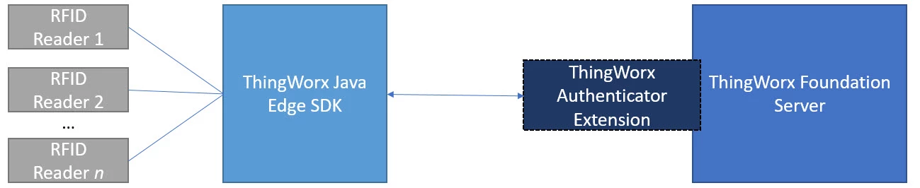

Hi, I am looking forward for any option to Login into Thingworx application through RFID tag reader, our moto to eliminate user has to enter username & password.
If RFID way is not possible, Then suggest some other ways.
Best answer by supandey
Hi @raj_selvaa50 you could connect your RFID device to ThingWorx via the ThingWorx Edge SDK, e.g. ThingWorx Java SDK, and you can build a custom Authenticator using ThingWorx Extension SDK, just to give high level diagram what I am talking about
Other option could be that you can configure SSO with ThingWorx, see Help Center doc here

Hi @supandey,
Thank you for your suggestion, I will try to explore this option in more details
