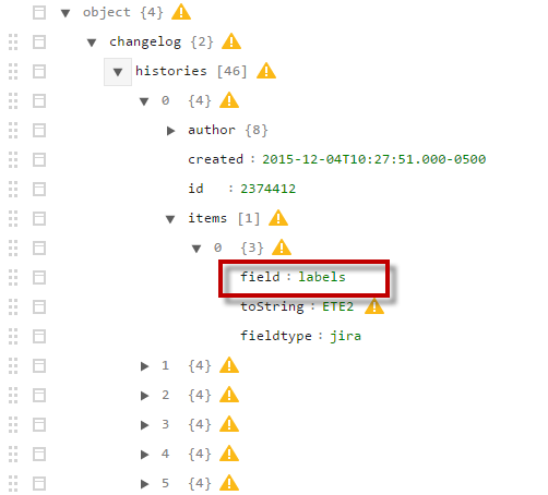

I am having a hard time to get this use case to work: I need to iterate through a JSON nested structrure and check some fields to populate an infotable. I tried many approach but did not get it working. Here is the structure:
I need to get the value of the field "fields" and check its value, and iterate it trough all the entries inside the "histories" structure. BTW, there is only one instance of Histories inside changelog.

September 29, 2016
Should be easy
// -- You need to create a DataShape with the structure you want the infotable, let's say it "MyDataShape"
var result = Resources["InfoTableFunctions"].CreateInfoTableFromDataShape({
  infoTableName : "InfoTable",
  dataShapeName : "MyDataShpe"
var histories = jsonJira.changelog.histories;
var history,item;
for (var i=0;i<histories.length;i++) {
    history = histories;
    for (var j=0;j<history.items.length;j++) {
        item = history.items;
        if (item.field==="whateverYouWantToCheck") {
            // -- Let's add the data to the infotable
            result.AddRow({  field: item.field, toString: item.toString, historyId: history.id });

Thanks Carles, I will try this approach to see if it is cleaner. For now, I seem to have achieved it by doing:
var jsonHistories=jsonJira.changelog.histories;
for(var i=0; i<jsonHistories.length; i++) {
     var items=jsonHistories.items;
     for(var j=0; j<items.length;j++){
          itemField=items
       if (itemField.field=="status"){
                    // jiraStates entry object
            var newEntry = new Object();
            newEntry.date = jsonHistories.created; // STRING - isPrimaryKey = true
            newEntry.from = itemField.fromString; // STRING
            newEntry.to = itemField.toString; // STRING
             result.AddRow(newEntry);
Which is quite similar to what you are proposing
