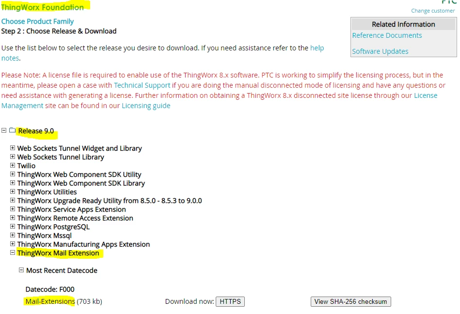

Hi @chrishanegraaf.,
The Mail Extension version 4.0.0 compatible with ThingWorx 9.0 is available on the PTC Support Download site.
Please let me know if this resolves the issue.

Thank you! I didn't think to look in the downloads page.
I installed it and verified that this fixed the email issue.
