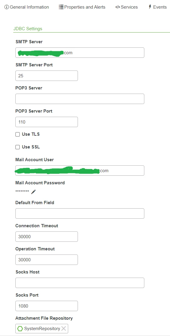

I'm new to ThingWorx, and my current version is 8.4. For the mail alert purpose, I imported the Mailserver Extension (V3.5.1). I tested sending emails from a Gmail account to an office mail, and it was working fine.
However, I want to send mail from one office mail to another office mail.
I entered my company's SMTP server name and port, which was provided by the IT department, but I am still getting the error message "Couldn't connect to host, port: xxxxx.xxxx.com, 25; timeout 30000."
also i tested the SMTP Server with telnet cmd its returned 220, seems good.
Mail Account User: I inserted the dedicated office email for the alert.
Mail Account Password: I left it empty, and also tried with the actual password of the mail account.
How can I solve this issue? Experts, please help me.

Hi @SS_11017218
Please check below points,
  1. Connection between Thingworx Server & SMTP Server
  2. SMTP Server IP & Port Number
  3. Firewall settings between Thingworx & SMTP Server
Could you please tell from which machine you tested telnet?
/VR

Hello @SS_11017218
You can check the following article to help you further
https://www.ptc.com/en/support/article/CS200624?source=search
if you still face the issue please change the logging level to trace and share the logs.
