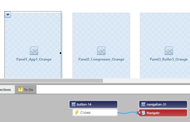

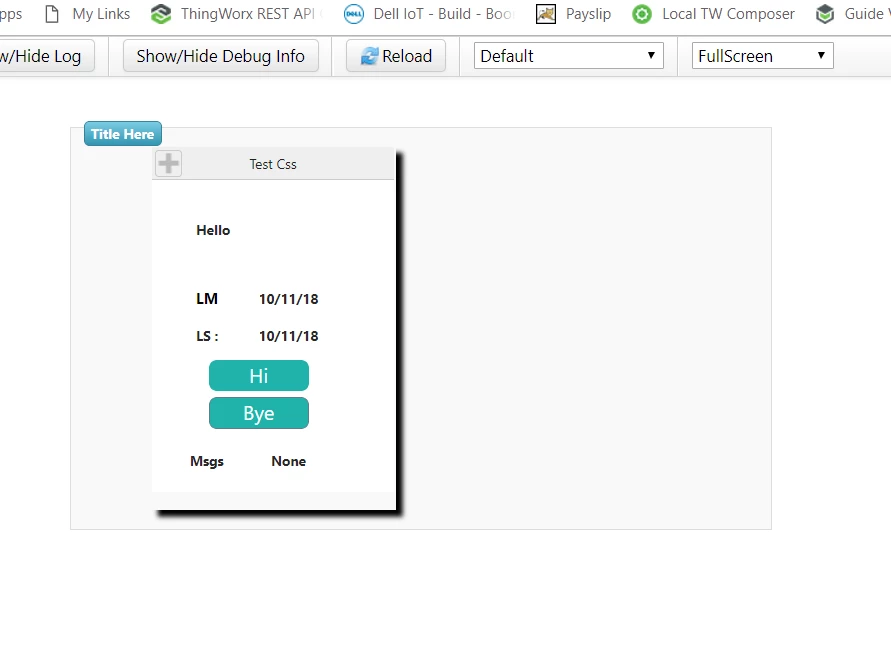

I am working around something like navigating to a different mashup on clicking of the contained mashup where i have used gadgets.
Again, is it possible to make whole contained mashup clickable or is it possible to make whole gadget clickable?
Here, I have implemented a rudimentary solution which is not at acceptable.(I have created a button ad made it as transparent color, which will be visible only on hovering on the contained mashup).
Let me know your thoughts on this.
This is what i have done so far. Now I need to make whole contained mashup clickable.

why is the Button not acceptable?
The whole Mashup surface is not actionable by default, through the button it can be exactly defined on which area (inter-) actions can occur.
I would place the content on the Widget / Gadget, then add the Button to make the whole Widget clickable and then add additional Buttons on top, and maybe also have clearly defined z-index to define the order of the Widgets.
I hope this helps...
