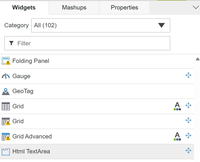

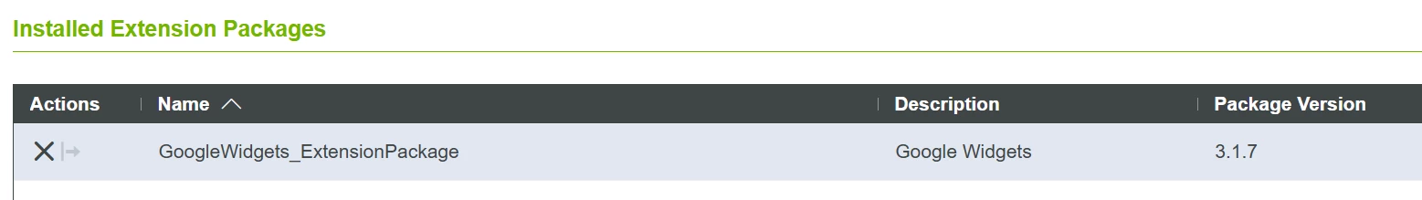

I have installed the IQNOX Thingworx Map widget from the website and I have Imported it to the Thingworx:
But the Map is not showing up in the Widgtes:
There is no widgets of google showing up:
Thanks.
Best answer by pshashipreetham
Hey ​@Nathaniel_S ,
Thanks for the response. This issue was resolved after clearing the Tomcat cache and restarting.
Thanks.

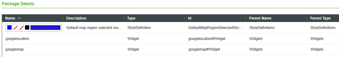

Hi ​@pshashipreetham
I tried to recreate the issue you described but was unsuccessful. Did you refresh Composer after importing? Also, could you please share what the package details for what you did import? Here’s what I have from my own attempt:
Best regards, Nathaniel

Hey ​@Nathaniel_S ,
Thanks.
