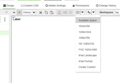

In the mashup design tab my full mashup is not shown, the lower portion of the page is cut off an not accessible; only what initially fits in the view window can be accessed.
I should be able to scroll down to see the lower portion of the mashup but I cannot. There are several containers and widgets that are cut off and not accessible to me now. This is a new issue that has occurred during my development.
I can preview or view the mashup and all containers/widgets are still present and active, they are only hidden out of view in the design tab. If I minimize the bindings/reminders/validation window at the bottom of the screen more of the mashup becomes visible as the view window is essentially expanded, this still does not show my full mashup.
Zooming out of the mashup design tab only shrinks the same portion of the mashup that was viewable, no additional portion of the mashup comes into view only empty space. Likewise using the pan mode only lets me drag the current view around and does not allow any additional portion of the mashup to come into view.

Hello, try to use that:
/ Constantine
/ Constantine
