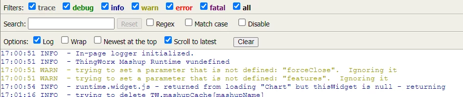

This is my first time posting something but now I'm getting an error that I've never had (It has worked before). Once I create a master mashup, configure my menu and identify the mashups related to this menu and the master mashup, I try to see the functionality, but I only get a grey screen. When looking at the log, I get a "null" value for the mashup I try to see (log.png). Do you know why I get this message?

have you set the menu property "DrivePageMashupOrBindToMashup" in the master mashup to "Drive Page Mashup" ?
Also you need to set the "Master" property on the involved mashups with your created master mashup.
If you open any of these mashups now the master mashup with the working menu should be displayed too.
Hope you have selected the menu in your menu widget configuration (menu property). Are you viewing the master mashup from the Administrator user only?
