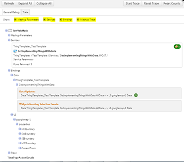

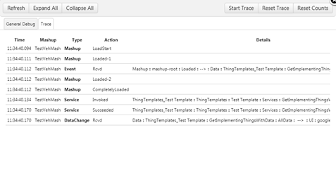

Hi Boris Mitioglov,
Could you please do the following steps and share the results to track the issue:
  • Click on View Mashup
  • Once the mashup opens under a new browser, click on Show/Hide Debug Info button.
  • This will open a sub window within the same browser tab.
  • Enable Mashup Parameter, Services, Bindings and Mashup Trace.
  • Now, Cick on Start Trace -> Reload -> Stop Trace (do not perform F5/Refresh as that will close this sub window)
Please share the Trace screen as shown below to debug the issue.
