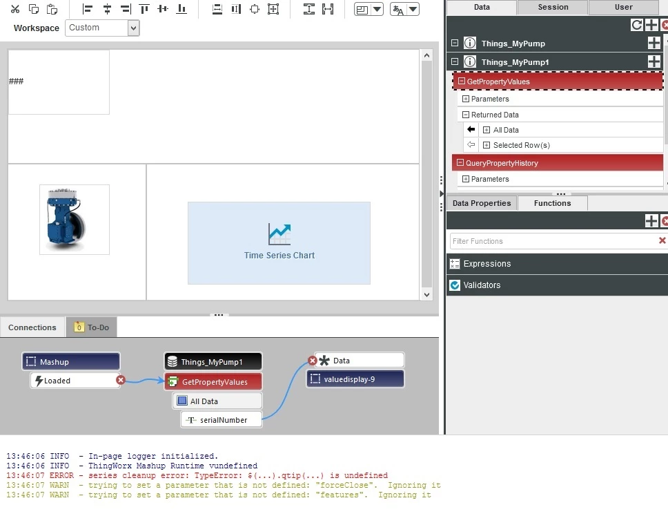

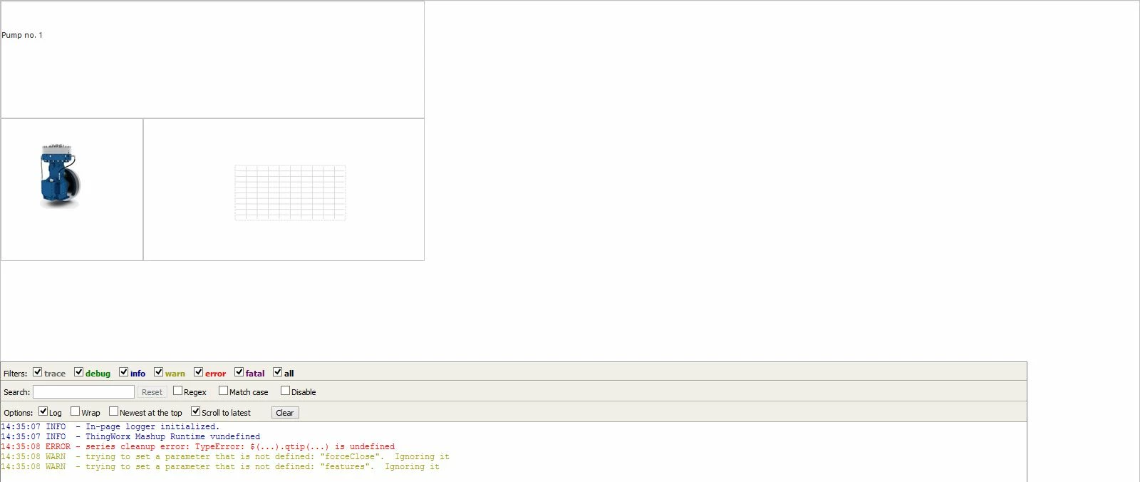

I followed this tutorial but the mashup is not showing any data. I am connected to a kepserver which generates some random numbers, which can be seen in properties tab. Thankyou!

Hello @BSUN_RO
Can you please check certain things?
1) Are you  getting any error in monitoring sections
2) Can you share screenshot of your mashup view
3) Are you not able to get data for timeseries chart only or it is missing for all of the other widgets too?

Problem is only with the data generated from the server. I can see for example the parameter with serial number.

I am using Thingworx 8.4.2. I don't have a line chart like in that tutorial, instead I use a "Time series chart" with line type. If I connect the data to a "Value Display", it's ok. Is there any way to make a chart though ? Thankyou for your time.
Support
Hi @BSUN_RO.
I ran through the tutorial up to the point you were having a problem and reported some issues I found.  Those have been corrected.
Note that ThingWorx 8.4 is no longer supported, but for the version you're running, you can try the Custom Charts widget found on the Marketplace.
