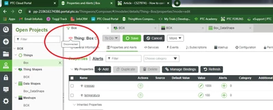

Hi, Team.
How I can fix it?
The Thing to attach on Mashupe is offline.
Regards.
Telles.

September 22, 2021
That indicates that the 'Remote type Thing' this entity represents is not connected.
This Thing is expecting a connection and information from maybe Kepware or a ThingWorx Edge Agent

September 24, 2021
Hi, PaiChung!
I´m using the Trail Version, and I don´t need communicate with Kepware yet or Edge Agent.
Regards.
Telles.
22-Sapphire I
September 24, 2021
Then you can just ignore that, the Thing will function fine even without being connected.
Not sure if this was a pre-created Thing, but else if you use a ThingTemplate that isn't based on RemoteThing or IndustrialThing you wouldn't see that at all because it won't expect connectivity.
