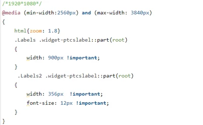

When using the Media Queries, the pop-ups are not getting center aligned...
The following code for the Media query has been used in the mashup
pshashipreetham
Sep 8, 2024 7:48 AM UTC
There is no solution for this at the moment. Each popup must be adjusted based on the media query used for each screen size. Therefore, using media queries is always a bad idea.

Hi @Shashi_Preetham.
We have a few questions/observations:
  1. You mentioned the screen size at the start of your code, but the media size exceeds that
  2. Your code doesn't contain anything regarding alignment
  3. What alignment are you seeing?  There is a horizontal alignment property.
  4. You mention the navigation widget in the Title.  What version of ThingWorx are you running?  The navigation widget is now a function.
