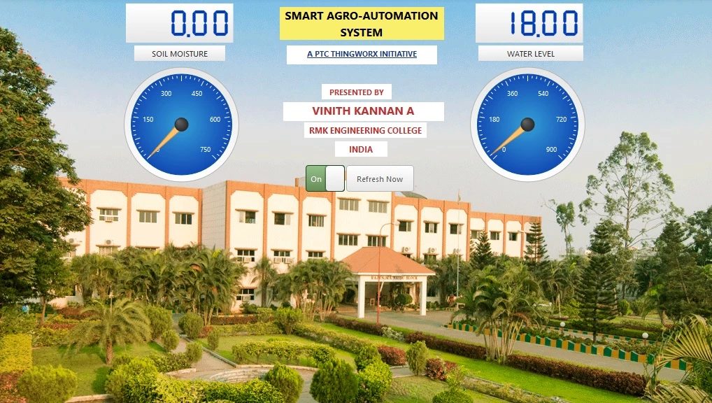

Well, I am working on an agricultural robot with regard to my project 'Smart Agro-Automation System'. Of course, I have completed the mashup stuff (image attached) and I am able to observe the values getting updated only when I click the Refresh button. Is there any automatic way of refreshing and updating the values so that it could enhance the end-user outlook ?

You can use the AutoRefresh in a hidden setup and that will automatically refresh your content.
then you can if need be add a regular button that is your request refresh NOW.

Looks like you have the AutoRefresh widget in place and working? All you would do is to remove the Visibile check.
Now refresh will trigger based on the time period you have defined. Then for aesthetics if you want a refresh on demand, you can just use a regular button.
