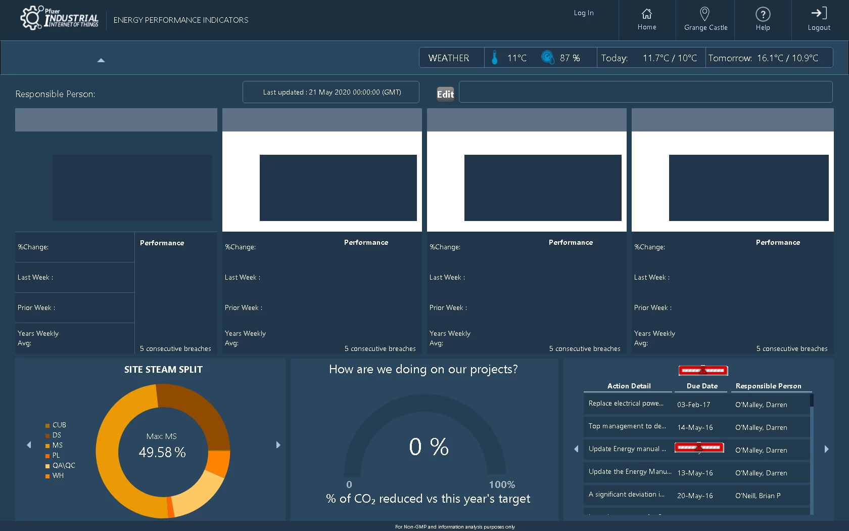

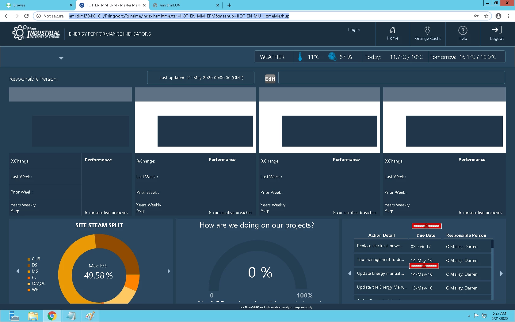

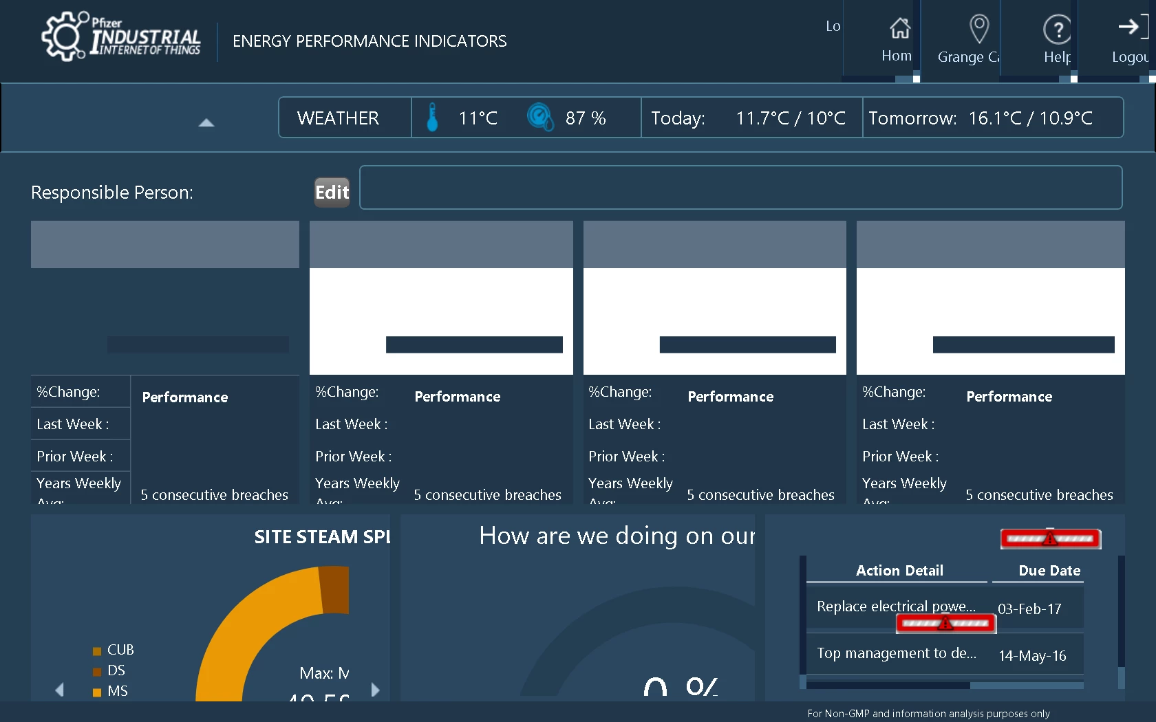

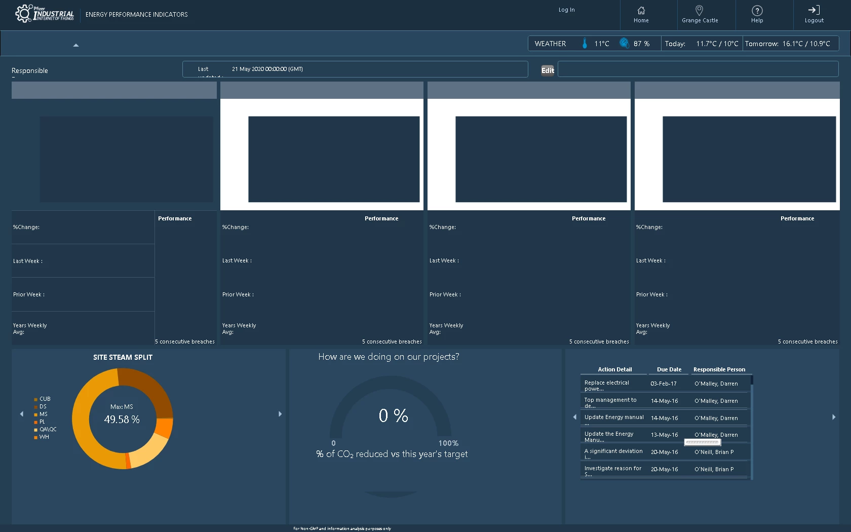

I have designed screen in 1680 *1050 resolution.It is looking perfect only in that resolution.Below is the attached application screenshots in different resolutions.No matter how much ever I try avoiding panels still i had to use them to meet design requirements.How do I design a fully responsive UI with no issues?

Hi @krishnakomal123.
Which version of ThingWorx are you running?  Newer versions of the platform make use of responsive containers with additional sizing parameters.
Regards.
--Sharon
8.3.3
Support
Support for ThingWorx 8.3 is being dropped this month, so it's recommended that you upgrade to a supported version.  Note, however, that ThingWorx 9.0 is targeted for release in late June/early July.
Regards.
--Sharon
