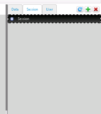

Mashup, session tab empty
Hello, maybe I didn't get it very well, but I'm working on Dashboard and I'm following the Lesson on Dashboard.
It talks about the Session Tab in order to drag the Entity parameter to the Data tab.
The problem is in my Session Tab I can't see anything
can you wonder what is this due?

There sometimes are Imports that contain ThingShapes that are assigned to the session.
However you can create your own very easily.
1. Create a ThingShape
2. go to the Subsystems and open the User Management Subsystem
3. Go to configuration and add the ThingShape to the session.

Oh, ok. So I can only do it if I have a thing shape.
I just have ThingTemplate and Things... that's why.
