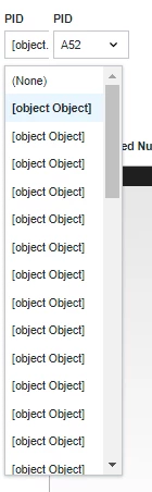

Mashup showing [object Object] after duplicating widget
Hello! I am running into some strange behavior after copy and pasting a widget from one part of a mashup to another. After duplicating I re made the bindings and confirmed they connect to the same entities. Is there anything else that doesn't copy over that I need to update?
The widget is a dropdown, in the picture I have the working original and not working duplicate side by side.

Are you sure you did the bindings exactly the same? [object] usually means that it is an infotable being displayed in a field that isn't for displaying an infotable.

Oops, I just forgot to set the ValueField from a selected row binding I had. Thank you!
