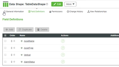

I'm developing a thingworx widget extension and i was trying to build a table based on an infotable returned from a certain service.
When the service returns the infotable data, the datashape is not ordered as i defined on the thingworx datashape.
The below image represents the datashape that i created:

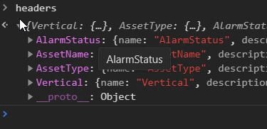

And the service returns, on widget extension, this order:
I want to receive original order from datashape.
Is there a way to fix this problem?
Thank you

May 21, 2020
Hi Constantine,
Sorry for the later answer.
Yes, i found that ordinal property that you mentioned the it fixed the problem.
Thank you very much for your answer.
