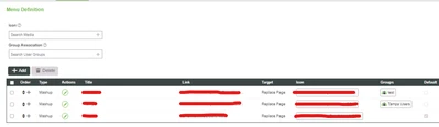

I have a menu with a user group assigned to each menu item as follows..
There are no users in the test group, and only a few users in the tampa group. However, I am still able to see these menu items in the UI when I sign in. I have tried non-admin user's as well as admin. All users can still see these menu items. What is wrong here? Shouldn't these items be restricted to the user within these groups?
This is version 9.0.4

could you call
result = Users["yourTestUser"].GetGroups()
in a custom service and check the result if only the expected groups are present? just to make sure that its not inheriting groups from somewhere.

How are you referencing this menu entity in the mashup? In a menu widget directly referencing the menu?
Sep 9, 2024 10:25 PM UTC
That is correct.
Sep 10, 2024 10:51 AM UTC
okay. It should be working like this. Not sure exactly if Admin will see all entries anyway (I assume so) - but you mentioned you checked with none admins.
I am not sure if there maybe an issue in the TWX version you reference.
But to make sure: Could you validate again that you reference the correct menu? As I also already debugged some stuff but noticed that I checked on the wrong entitiy.
