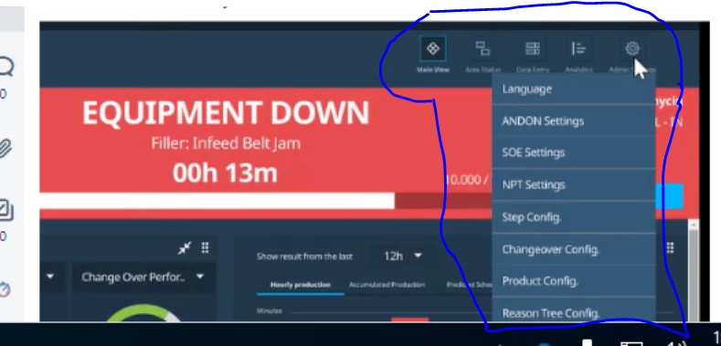

Hi ,
I need to create Menu and subMenu with Horizontal Alignment of Menu item. as shown in attached file.
how to achieve this in Twx 9.3.0 , with Icon need to add Menu Item. what widget is suitable here if we see Sub Menu as well in small popup.

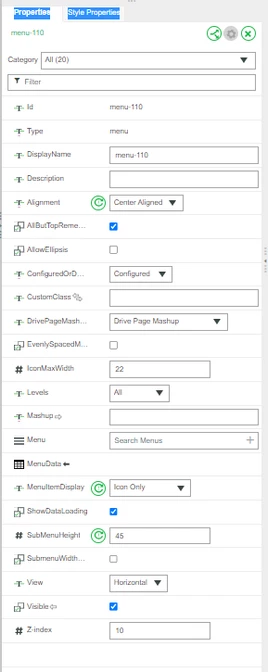

Make the settings as follows:
Then you will be able to achieve following
Hope this Helps!!

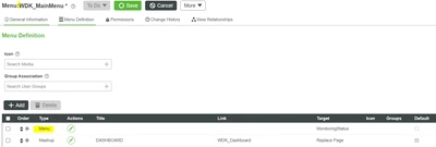

Feb 9, 2023 8:46 AM UTC
You can use menu as Type while creating menu item.
Feb 9, 2023 9:34 AM UTC
Hi @Sathishkumar_C ,
I will get menu but how we can show sub menu in small popup as shown in attached file.
there is no option to select Target as popup. only new page and replace page is there. pls can you elaborate more on this.

Hi ,
Hope this Helps!!
