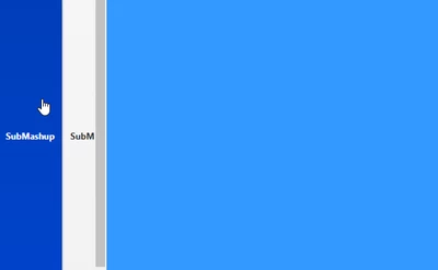

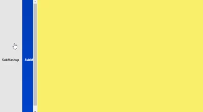

I am facing issues regarding Menus not changing Contained Mashups and instead overriding the parent mashup when clicked. This issue was noticed when loading projects developed on Thingworx 9.3/9.4 onto Thingworx 9.5 (ThingWorx 9.5.4-b764). The attached project functions as intended on Thingworx 9.4 (ThingWorx 9.4.0-b49) but not on Thingworx 9.5.
The menu is correctly configured (having DrivePageMashupOrBindToMashup set to "Bound to mashup parameter"). Like I said, the exact same configuration functions correctly on TW9.4 but not on TW9.5.
