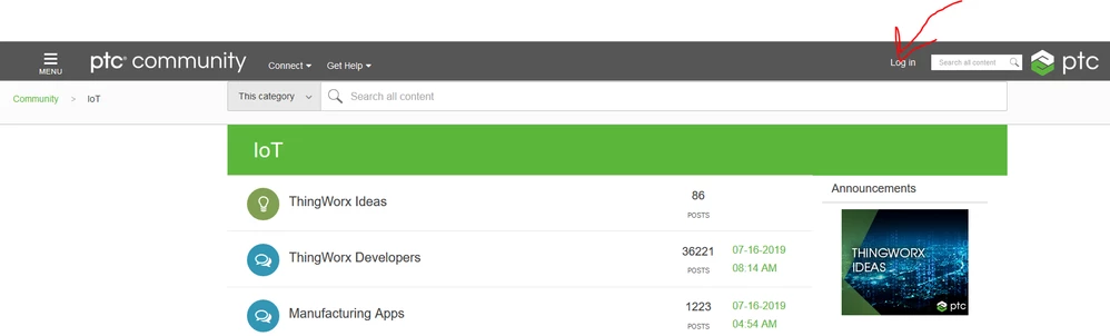

Thanks, but unfortunately the green button "Suggest an idea" is disabled for me, so I cannot send new idea there.
Support
July 16, 2019
Hi @mett.
It sounds like you're not logged in.  Just click the login button in the upper right.
Regards.
