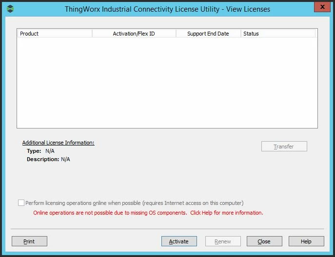

Hi Developers,
I'm using ThingWorx-Industrial-Connectivity-8-3.
I had crested a new channel with Driver as Modbus TCP/IP Ethernet and with below properties. Property groups were set to default values. Then i added a device. I'm getting the following Licensing warning.
Time limited usage period on feature Modbus TCP/IP Ethernet has expired.
How do i validate if i have proper licenses?
Please provide help on this.

Hello @SaranKarthick,
You can use "LicenseUtility" application to validate your license.
VR

Sep 3, 2018 9:16 AM UTC
Hi @Velkumar,
Based on your suggestion i looked into license utility and found my license page in the below state.
I'm following a guide ("https://www.kepware.com/getattachment/72292526-7770-4dfb-af73-2e0ab779cd57/license-utility-manual.pdf " ) to activate my licenses. But I'm not able to find the activation id. Is it auto generated or will be given in some shipment documents.
Saran
Sep 3, 2018 9:42 AM UTC
Hi @SaranKarthick
You will get activation ID when you purchase kepServerEx license.
VR
