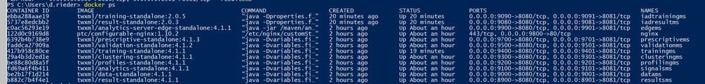

Hello everyone,
when trying to publish a model from the Analytics Builder i get the error message:
"Model deployment failed on connector TW.AnalysisServices.ThingPredictorConnector", eventhough i was able to create a thingPredictor in the Analytics Manager.
I have read the other threads regarding this problem, but they dont work for me. It seems you need to download the predictor package, what i can't because i am working with the trial version currently.
Any help is appreciated very much.
Best Regards,
Dominik

Hi Dominik
I got some confirmation that the ATE version that includes the configuration for ThingPredictor is 8.2.0 r3 and the one you downloaded is 8.2.0r2 which does not include the configuration.
I have contacted the Dev Zone team to correct the version.
Nevertheless I have documented some additional steps that should allow the 8.2.0r2 to work at https://www.ptc.com/en/support/article?n=CS284194
Hope that helps
Christophe

Hi Dominik
Could you please clarify which trial Edition you are using:
- what is the name of the media zip file you downloaded ?
- where did you download it from ?
I am asking because in the output of your docker command we see only ThingWorx Analytics components, you should also have a ThingWorx Foundation to work with ThingPredictor.
Since you are accessing Builder you clearly have one, but where is your ThingWorx Foundation installed ? is it also a trial, if yes, same question as above what is its name and where did you get it from .
This is important to clarify your environment and see how to make it work.
Christophe

Hello Christophe,
thank you for replying so fast again! I downloaded the Analytics Trial version from https://developer.thingworx.com/resources/downloads.
The zips name is "Thingworx-Analytics-Trial-Edition-8-2"
My foundation server is indeed a trial version aswell which i installed manually before (Not the Docker installation) with Tomcat. I managed to only install the Analytics Server Component and connect it with my foundation server. My foundation server is running on version 8.2.1 btw.
I tried to use the overall installer (which also installs a foundation server) but i can some post installation errors.
Let me know if you need any additional information.
Dominik
