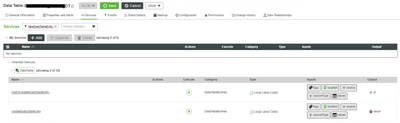

hello,everyone!
I want to change the data in the table automatically through the service.Please tell me what to do.企业微信截图_17092786501957.png

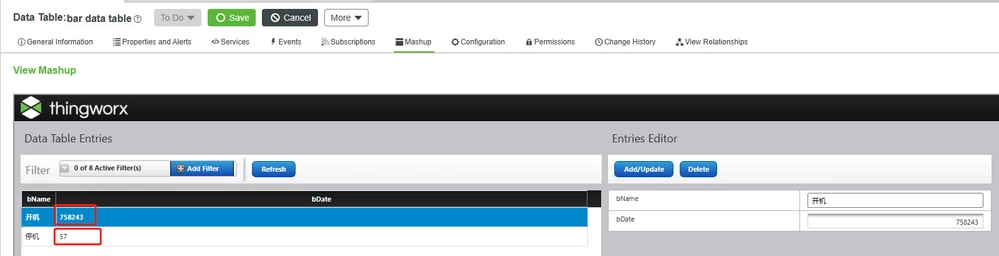

Hi @Velkumar
I tried it and it did work, but how can I get to the point of automatically changing the value through services and subscriptions?

Hi @Rocko
