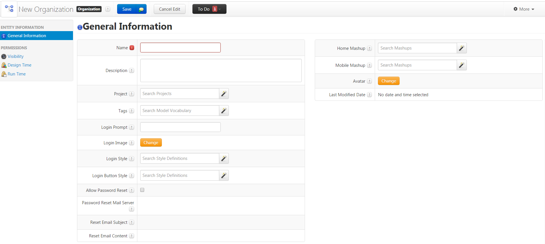

All the available options can be check in the organization entity.

I have already checked these but no luck.
I guess there is no way to edit TWX default HTML code of this Login page.

But this is not 100% sure you could do what you really want finally, just have a try, like Ankit mentioned, what officially provided are all in the Organization General Information page configure, but for other non-out-of-the-box functions, you should try to look at the jsp page and know which Thingworx API could help in the jsp page.
