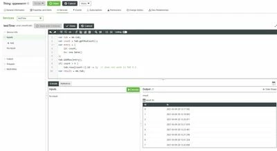

I attached a small datashape and a thing to test this.
TestInfotableDS only contains two values: id (long), ts (Date).
The thing TestInfoTable has an infotable of this shape and one service addRow().
var tab = me.tab;
var count = tab.getRowCount(),
var entry = {
 ts: new Date()
tab.AddRow(entry);
if( count > 0 )
 tab.rows[count-1].id -= 1; // does not work in TWX 9.1
 * uncomment to make it work in TWX 9.1!
 * But why does AddRow reflect back to property and in place mod not?
// me.tab = tab;
var result = me.tab;
As described in the Thingworx Help - Infotables the local variable tab reflects back to the property me.tab.
But each time a row is added to the infotable the id of the previous row should be decremented by one.
This happens in Thingworx 8.4 & 8.5 but not in THingworx 9.1.
Is this intended behaviour? How can I modify values in an infotable in place?

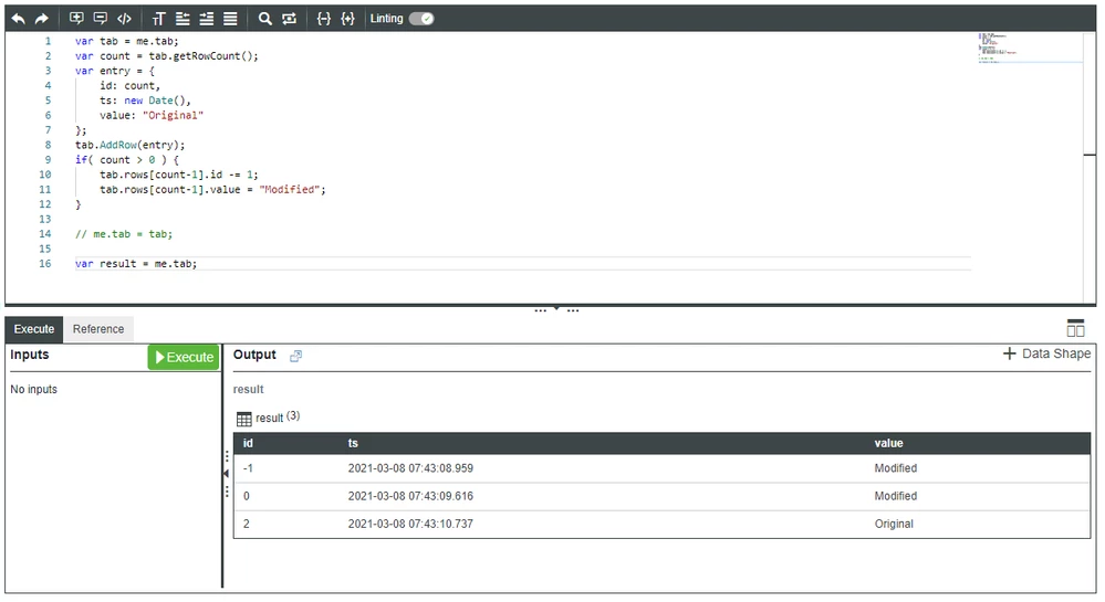

To make it more clear I modified my code and extended the DataShape by a string value:
var tab = me.tab;
var count = tab.getRowCount();
var entry = {
 ts: new Date(),
 value: "Original"
tab.AddRow(entry);
if( count > 0 ) { // if there is a prev row, modify it!
 tab.rows[count - 1].id -= 1; // does not work in TWX Version > 9.0
 tab.rows[count - 1].value = "Modified"; // does not work in TWX Version > 9.0
// me.tab = tab;
So when I execute this Service 3 times I get different results for TWX 8 & 9.
In Thingworx 8.x it's:

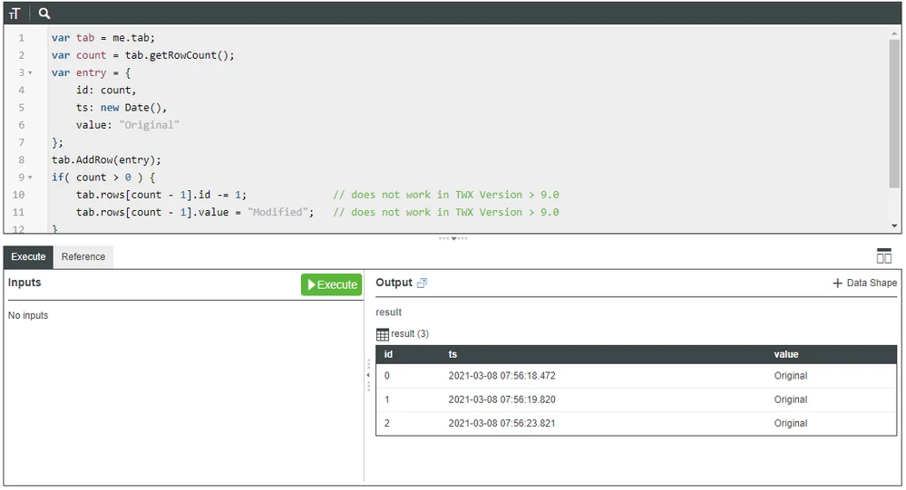

 When I do the same in Thingworx 9.x:
2021-03-08 07_56_31-Services _ TestInfoTable und 3 weitere Seiten - Geschäftlich – Microsoft​ Edge.png
So it seems that in place modification of Infotables is not possible any more strating with THingworx 9.0!
That's horrible for many of our internal logics ...
If this is intended behaviour I would expect a huge exclamation mark in the Documentation.
ATTENTION!! Behaviour of in place operations changed!
