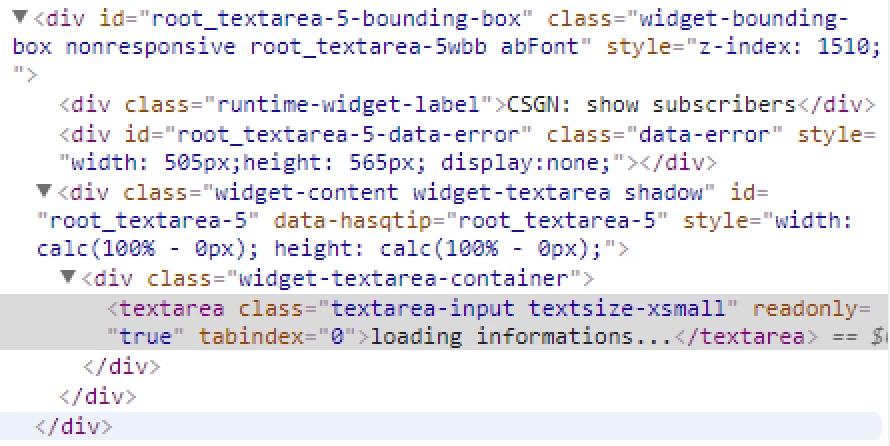

However when I save and preview the meshup I see that abFont is applied to the outer bounding-box.
The font information is however overrided between such outer bounding-box and the inner textarea where the font is supposed to be monospaced...
How can I fix this ?

Thanks for including the page source with your question, that really helps.
Have you seen this guide to CSS:Style UI with CSS>Apply Custom Class to Widget
I think you need to add
.widget-textarea textarea
to your class, making your class look like this
.abFont .widget-textarea textarea {
 font-family: Courier;
I don't think the !important does anything

abuzzi1-VisitorAuthor
April 21, 2018
Hello alsmith,
what you say does really make sense and even more important.. it works!
Thank you so much,
