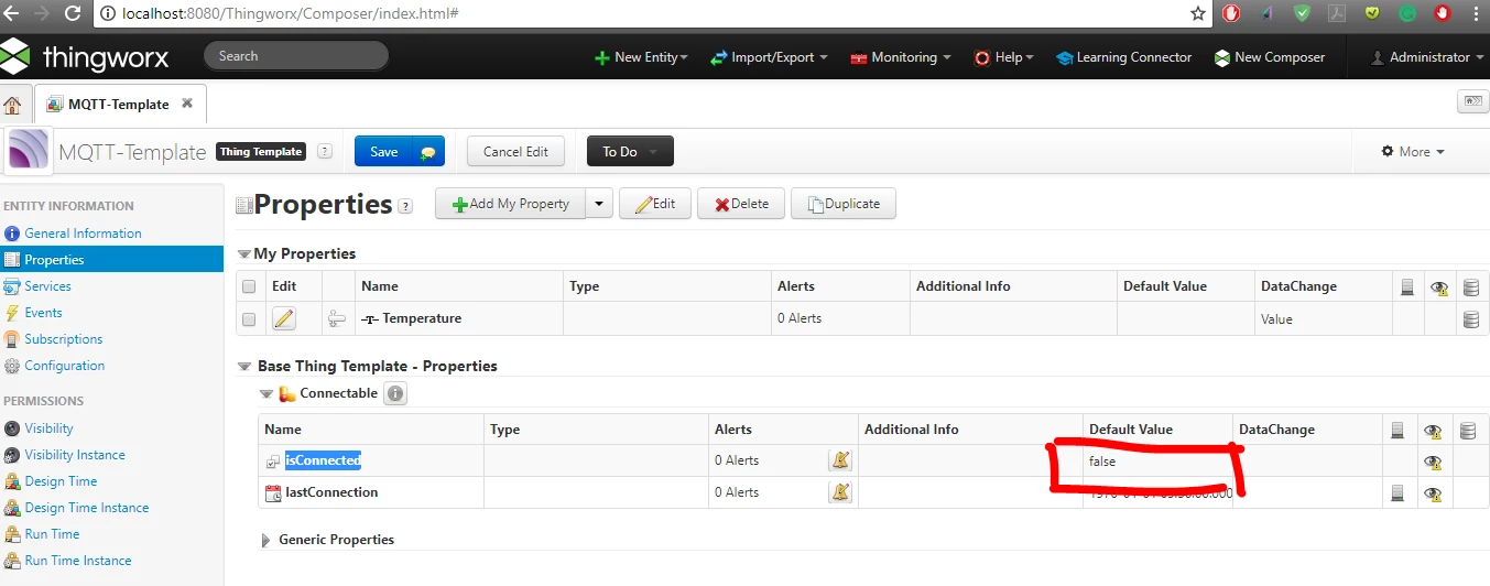

I am trying to implement MQTT using the extension but in my MQTT thing template the "isConnected" never turn "True" it's always "False". I have changed the MQTT servers as well as used the local MQTT server but the issue remains.
