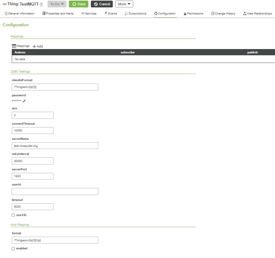

I don't get why my "TestMQTT" Thing doesn't connect to my MQTT-Broker.
Basically i did this:

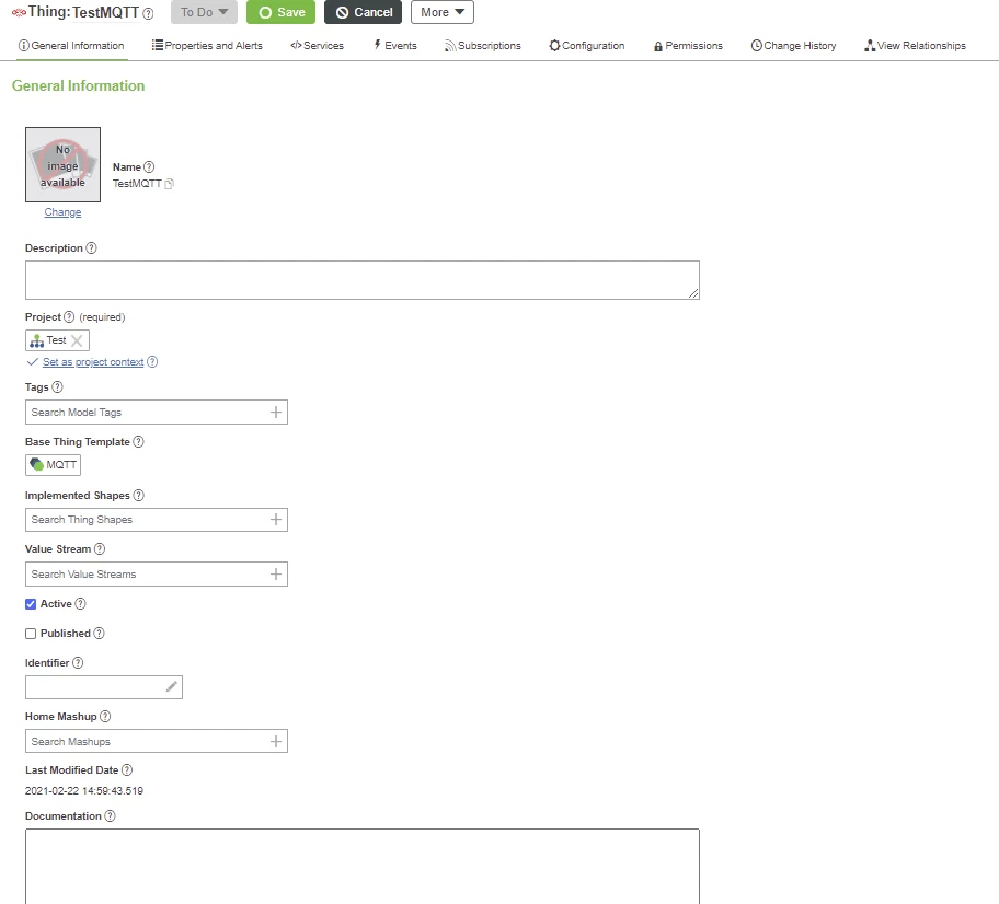

I created a NewThing with ThingTemplate "MQTT"
in Configuration I tried to use "test.mosquitto.org" with 1883
This should be enough to get the "green connect icon", or do I miss something?
I use ThingWorx 9.1.0 and MQTT_Extension 2.1.0.
Thanks for any kind of help!
