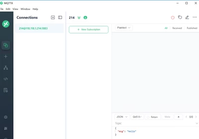

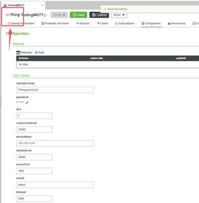

I am using ThingWorx version 9.3 with the MQTT Extension version 3.1. After configuring MQTT, the connection remains in a disconnected state, but it has been verified to be connected through a client tool.
Feb 11, 2026 11:12 AM UTC
Hi @ST_10465152  Can you take a look at the article below and let us know your output?
https://www.ptc.com/en/support/article/CS398400
8-Gravel
Feb 12, 2026 6:46 AM UTC
Thank you so much, it worked! I was indeed using version 2.0 of the MQTT extension, and switching to version 3.1 still didn't resolve the issue. After reading the article, I cleaned the extensions in Tomcat, restarted ThingWorx, and reinstalled the MQTT extension, which finally fixed the problem
