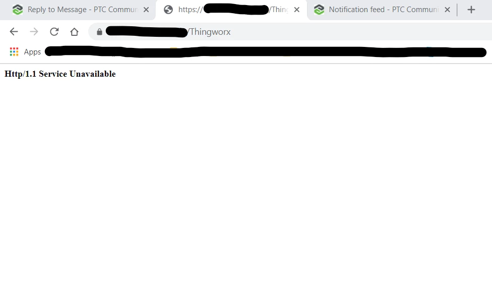

I don't know if it got restarted since Friday.
I will try this, but at the time it even got worse and I am not able to open the thingworx composer (see attached picture).
Is this a licensing problem?
Or maybe it doesn't let me in, if there are too much user currently working?
At first glance this does not seem license related, however you can double-check if you have a valid license by going to Monittoring > Subsystems > LicensignSubsystem and check the expiration dates of your features.
Could you attach today's ApplicationLog.log (located under ThingworxStorage/logs) ? Those might help understand what kind of issue is affecting your server.
