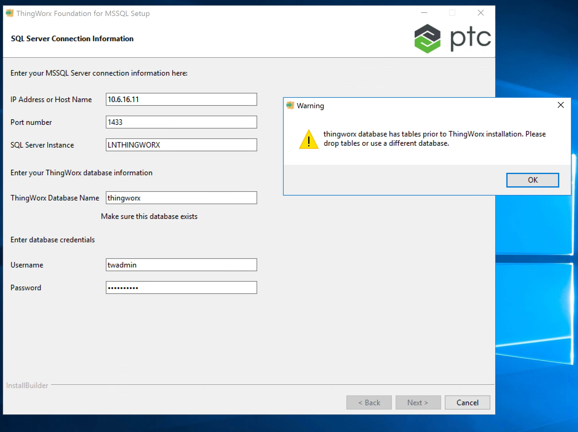

MSSQL server 2016 and ThingWorxFoundationMSSQL-8.5.4-x64.
Trying to install ThingWorx Foundation using the installer provided.
MSSQL server has been setup using these instructions https://support.ptc.com/WCMS/files/172634/en/Getting_Started_with_MS_SQL_Server_and_ThingWorx_1.pdf
The Install builder is giving me an error at the ThingWorx Foundation for MSSQL Setup part.
At this point after I enter all the server connection/login information and I hit next I get this error
"thingworx database has tables prior to ThingWorx installation. Please drop tables or use a different database."

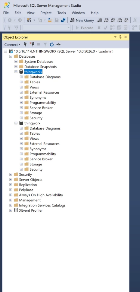

I also tried creating a new database and giving it a different name (thingworkx instead of thingworx) but that didn't help either. I am really new to the ThingWorx world so any help is greatly appreciated. See screen shots for reference. I found one article but that was for PostgreSql and now MSSQL. Here is the link to that https://www.ptc.com/en/support/article/CS320445

Hi @nkhoja.
While working the case we found that a 32-bit version of Java 8 was installed.  In addition, Java 13 was installed and the installer was trying to use this version, which is not supported.  By removing both versions and installing the 64-bit version of the Java SDK 8, we were able to resolve the issues resulting in a successful installation.

Support
Hi @nkhoja.
If you are using one of the installers, you simply need to create the database and set the appropriate options.  You should not run the scripts indicated in the documentation you referenced as the installer will take care of creating and populating the tables.  Please refer to these instructions and let us know if you still have questions.
