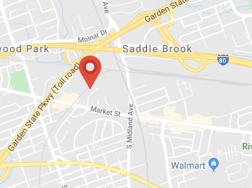

Is it possible to have multiple markers at the same location?  I noticed that I can only see one marker when they have the same geocode.  I need to be able to see all markers that are located at the same location.  They don't split up even if I zoom in.  I can only view one of the tool tip mashups since the other markers are hidden behind the first one.
Best answer by slangley
Hi @Willie.
We don't currently offer this functionality.  However, you can request it via the ThingWorx Ideas site. This will allow others to vote on your suggestion.
The alternative is to write your own extension.  Please refer to this page from our Help Center for assistance.

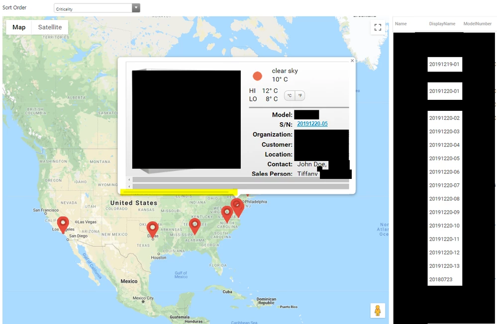

December 23, 2019
Hi @Willie.
It looks like it only shows the active point. Without knowing your use case, one option could be to create a list and use that to select the desired one in the map.
Regards.
--Sharon
Willie16-PearlAuthor
December 23, 2019
Hi @slangley ,
I am trying to display all remote things on a list on the map.  Please see the screenshot below.  The list is shown on the right.  When a remote thing is located in the same location as another remote thing, the markers overlap and I am unable to bring up the tooltip mashup of the markers of the remote things in the same location.
