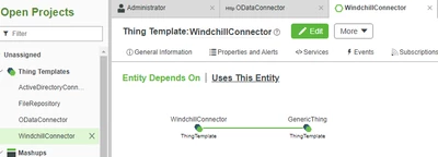

I'm using ThingWorx Foundation and Navigate 9.1. WindchillConnector is a (deprecated) ThingTemplate, not a thing, and has nothing to do with ODataConnector. I have no idea what is this "WindchillConnector" thing you have under ODataConnector. Isn't it something custom? Look what I have :
But never mind WindchillConnector.

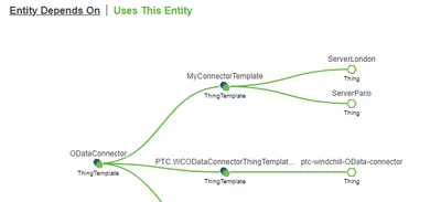

Now imagine I have two servers: ServerLondon and ServerParis. I create a ThingTemplate named "MyConnectorTemplate". I made a picture describing the architecture I want:
I want my services to be declared on MyConnectorTemplate, and servers configurations set in their Thing.
I can't to that, because I can't define custom EndPoints at ThingTemplate level (Cf. CS284781 article). For what I know one can only redefine EndPoints in a Thing, which would only be acceptable if I had only one server.
