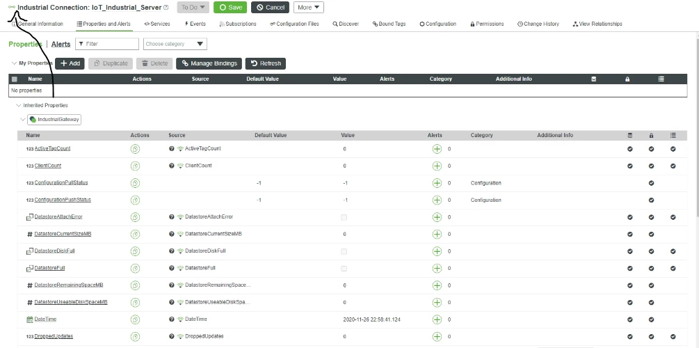

my industrial thing is disconnecting

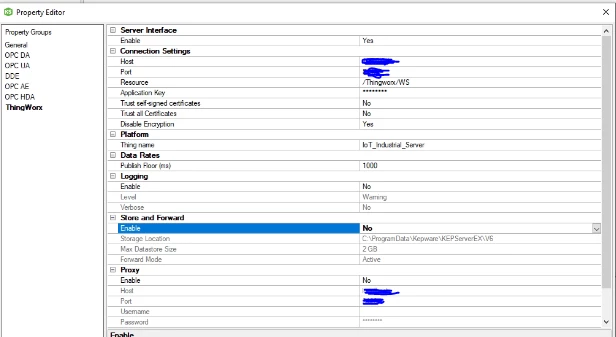

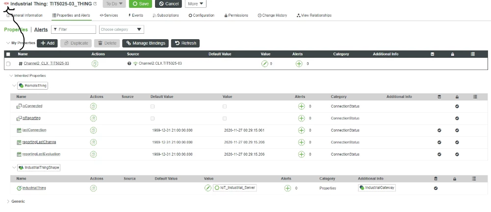

I achieved the connection between kepware and thingworx, but when I create the remote thing it appears to me disconnected, even though the industrial connections are connected.
checking the properties of the remote thing, the isConnected property is without value ... how do I solve it?
and checking the AplitionLog it throws me the following messages:
Unable to dispatch [ uri = /Things/IIoT_Industrial_Server/Services/BulkLog/]: Entity IoT_Industrial_Server does not exist or is not yet associated with a Thing
error executing APIRequest Message: Entity IoT_Industrial_Server does not exist or is not yet associated with a Thing, sending ERROR ResponseMessage to caller!
¿cómo lo resuelvo?
thanks for your help

Hi @DC_9669845 , It may be related to the app key permission . I suggest you to try with admin key.
Regarding the potentially unrelated Bulk Log error, the bulk log is related to sharing  event log. That error occurs when the entity hasn't had the xml update process completed as per the  article about app key permissions but it doesn’t necessarily relate to the symptom of connected industrial gateway but disconnected remote things.
Please have a look on the article
https://www.ptc.com/en/support/article/CS279741?&language=en&posno=2&q=app%20key%20permissions&source=search
