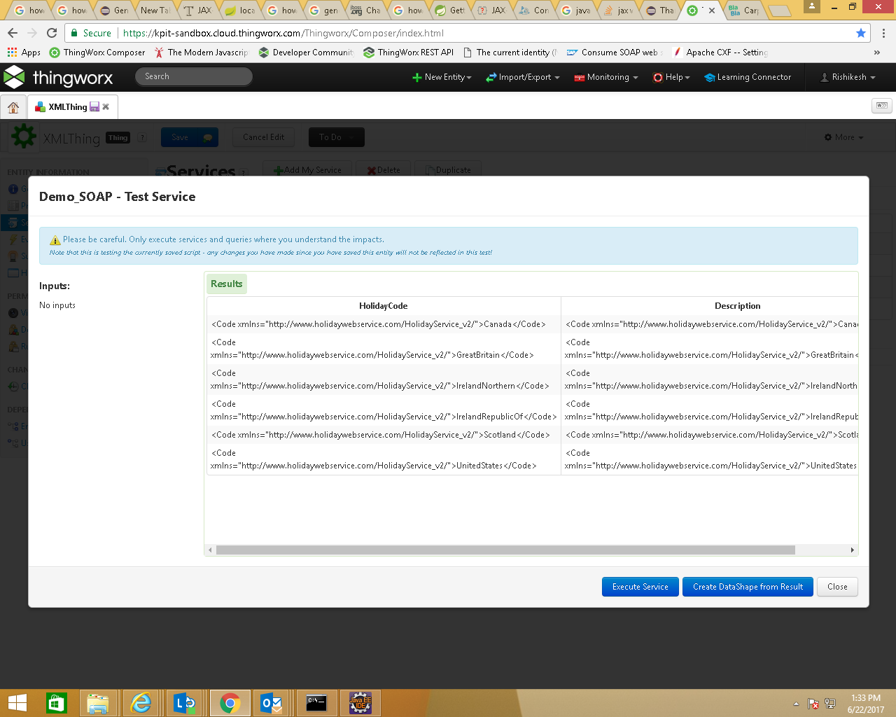

June 22, 2017
Hi Rishikesh Salunkhe​,
I tried this a bit and i was able to read some data using following code. Please make changes as per your requirement.
StringDataShape is a datashape with a String field named StringValue

var resultXML = Resources["ContentLoaderFunctions"].GetXML(params);
var params = {
  infoTableName : "InfoTable",
  dataShapeName : "StringDataShape"
// CreateInfoTableFromDataShape(infoTableName:STRING("InfoTable"), dataShapeName:STRING):INFOTABLE(StringDataShape)
var result = Resources["InfoTableFunctions"].CreateInfoTableFromDataShape(params);
var newRow = new Object();
for each (var tag in resultXML.*::portType.*::operation.*::documentation) {
    newRow.StringValue = tag;
    result.AddRow(newRow);
I hope it helps.
rsalunkhe1-VisitorAuthor
June 22, 2017
Here is my output.
ankigupta5-Regular MemberAnswer
