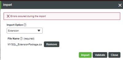

I have a problem when I import “MYSQL Extension Package” on the ThingWorx Platform, it gives me this Error “Error Occurred during the import” also when I press Validate button it gives me the same Error “Error Occurred during the Validation”.
I have been tried many versions of Database Extension but I faced the same problem.
notice i have tried to find another version but i cannot find anything in the Marketplace.

What is your ThingWorx version? Instead of importing MySQL extension in UI, can you download the MySQL JDBC driver and copy it into Tomcat/lib folder? You have to restart the Tomcat after copying JDBC driver jar.

Is there any more information in the application log?
