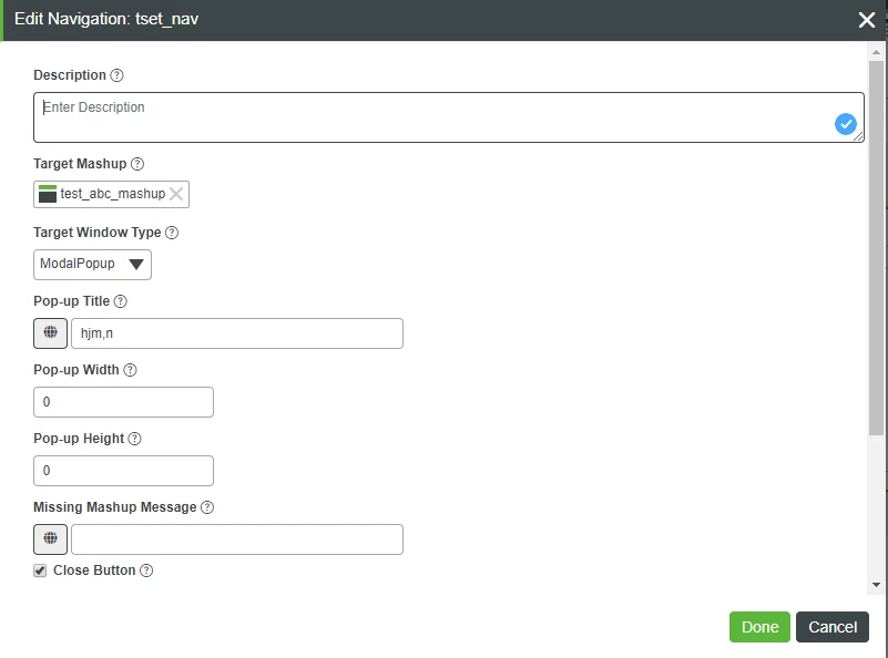

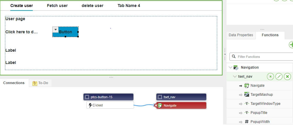

I am trying to show a mash up as a pop up when user clicks on a button using Navigation function.
I have entered the target mashup, Target window type -- Modal popup and other required details. When I clicked on the button, I can see a pop up but the pop is empty. I am not able to see the mashup I gave as target and the pop up is empty. I followed the below link for reference.

What ThingWorx version do you have? We encountered similar behavior in 8.5.0, which fixed itself once we upgraded to 8.5.1.
