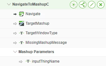

I would like to set up navigation so when the user clicks on a Machine in the Collection, the Thingname of the machine (used to populate data on Mashup B) is passed to Mashup C.
Now, I can get this to work by setting up a Navigation Function on Mashup A and binding the Collection CellWasClicked Event to the Evaluate input and the Event:Thingname to the Parameter of the Mashup. This works at runtime, until I refresh the composer and I get "Obsolete bindings for <NavigationFunction>" and the Mashup Parameter binding is removed.

This message is displayed after I refresh the composer and it removes the binding.
Another instance I have found this morning, I also see the same behaviour when trying to bind SelectedRows from a Grid Advanced widget to Mashup Parameter of a Navigation function

Not really, in the example posted the binding of the Mashup Parameters in the Navigation function is gone. Which is exactly my issue.
FYI, I have been given a workaround of doing the same thing but using a Navigation widget, which works. Once you have that working, you can let the Composer upgrade the widget to a Navigation Function and you can still bind mashup parameters to the function.
There appears to be an issue with the normally created Navigation functions, they are somehow different to the ones upgraded from a widget. It's a known issue at some level within PTC, unsure how seriously it is being worked on.
