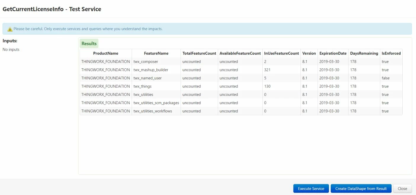

Need information about twx_named_user feature. It showing as false.
I have installed Thingworx 8.3 on Ubuntu platform. The license is installed successfully.
The license file was able to rename as "successfull_license_capability_response.bin".
After running the "GetCurrentLicenseInfo" service from the LicensingSubsystem, twx_name_user
is showing as false. I need some information about the feature. What could be the impact of this feature
if it does not appear as true?

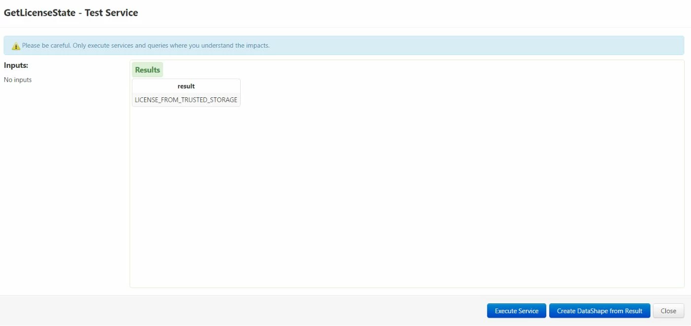

I have attached the screenshots of the output of below services:
GetLicenseState
Please help on this.

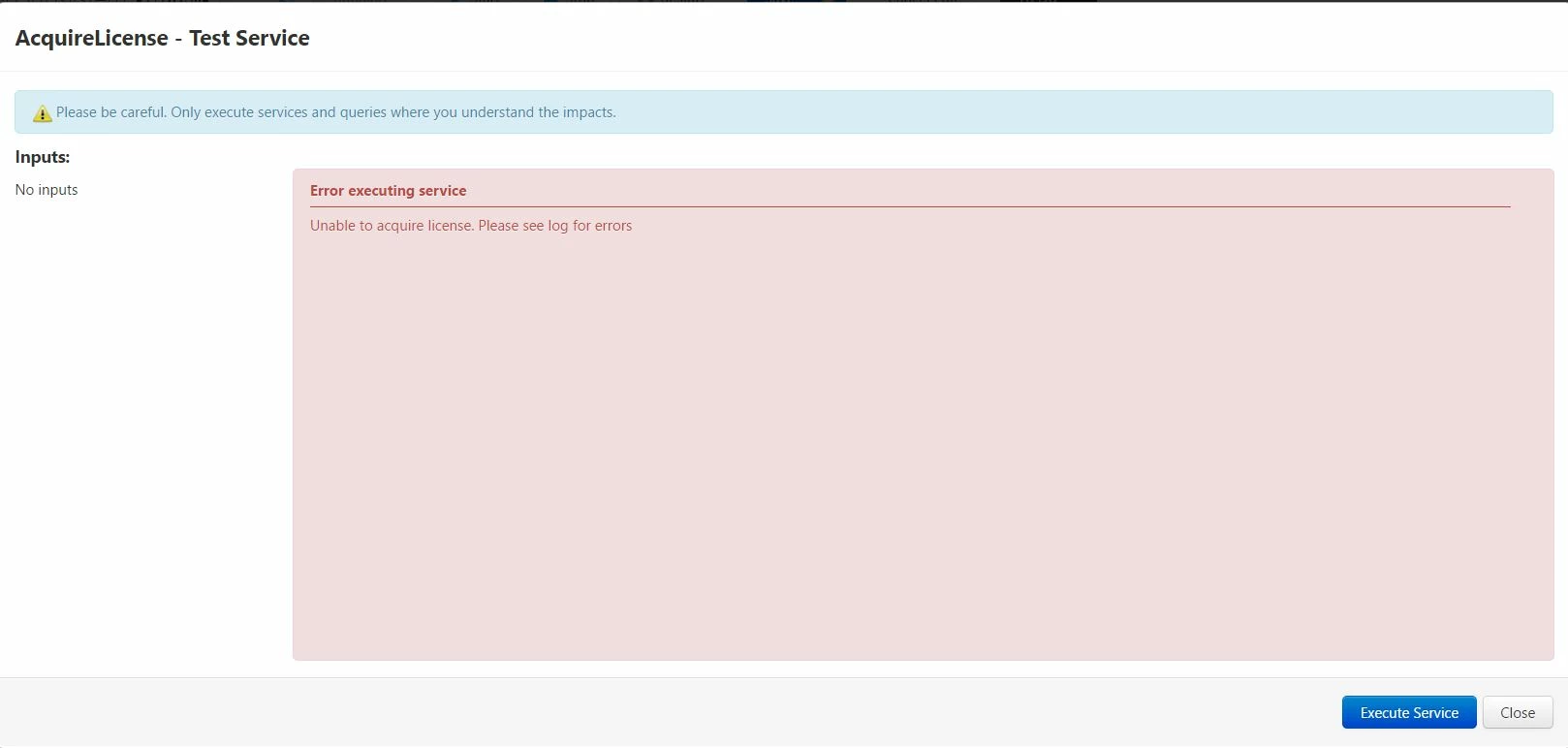

What happens if you run "acquire license" service in the licensing subsystem?
vgarg1-VisitorAuthor
Oct 5, 2018 5:39 AM UTC
After running the acquire license service it gives the below message:
Unable to acquire license.  Please see log for errors.
I have attached screenshot of the service also.
PFA
Please find the application logs also:
2018-10-05 10:46:26.179+0530 [L: WARN] [O: c.t.s.s.l.LicensingStateMachine] [I: ] [U: Administrator] [S: ] [T: https-jsse-nio-443-exec-4] Failed downloading license_capability_response.bin from FNO server. This will be expected if the ThingWorx Platform is running in disconnected mode.
2018-10-05 10:46:26.179+0530 [L: WARN] [O: c.t.s.s.l.LicensingStateMachine] [I: ] [U: Administrator] [S: ] [T: https-jsse-nio-443-exec-4] No license changes, because neither license.bin or license_capability_response.bin could be found
2018-10-05 10:46:26.789+0530 [L: ERROR] [O: c.t.w.BaseService] [I: ] [U: Administrator] [S: ] [T: https-jsse-nio-443-exec-4] [context: com.thingworx.webservices.context.HttpExecutionContext@542514c6][message: Unable to acquire license. Please see log for errors]
2018-10-05 10:46:52.234+0530 [L: ERROR] [O: c.t.w.BaseService] [I: ] [U: Administrator] [S: ] [T: https-jsse-nio-443-exec-1] [context: com.thingworx.webservices.context.HttpExecutionContext@18d029ca][message: Unable to Invoke Service QueryLogEntries on ApplicationLog : Java heap space]

Go in the Composer -> System -> Subsystems -> LicensingSubsystem -> Services.
Find the service called “GetInstanceID” and execute it (by clicking “Test"). Copy the result.
Follow this guide to obtain the license file:
https://support.ptc.com/lm/ThingWorx_Navigate_8.1_Licensing_Instructions.pdf
