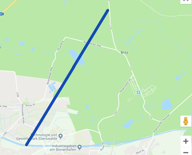

Dear Constantine,
Thank you very much for your immediate support and its working but I am not able to show any(car) icon when route is progressing. How to show the icon?
Right now I am simulating route data by incrementing linearly. So my guess is since the data is incrementing linearly the line as shown in the picture is linear. And when integrating with the real feed we will see the wavy nature of the curve? Please correct me on this if I am wrong
Very greatful if you can provide support on this ASAP and please find the attached image.

Hello Vijay,
  1. To see separate points, try to mutate your location components randomly every time you store it in the value stream, e.g. { latitude: lat * (1 + Math.random() * 0.01, longitude: lon * (1 + Math.random() * 0.01 }
  2. You can see the points, if you bind the result of QueryLocationPropertyHistory also to Data property of the Google Maps widget. If you only need to see the last location, then you'll need to call a separate service for that, which returns only one row in the INFOTABLE.
/ Constantine
