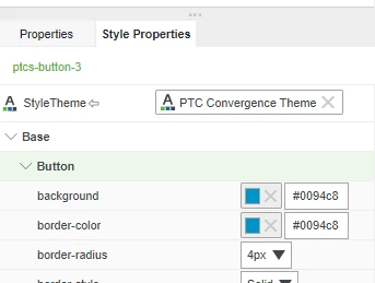

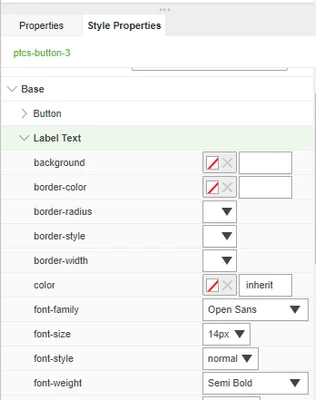

There is no need to do this using CSS, you can change the background color and font size of the text using the built in functionality.
This is also the recommended way by PTC.
Background color:
Font size:
Perhaps if you use a lower version of Thingworx this might not be possible. But if I remember correctly it should at least be possible from 9.1.

HI @jensc,
It is not picking mentioned font-size in style properties as per your suggestion. It is displaying some different values. I even tried to remove style theme as well, but didn't help. but if i refresh the mashup in runtime, then it takes correct value as specified in style properties.
That is why I had to change via css.
