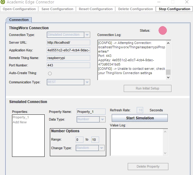

No able connect thingworx server using academic edge connector
please provide steps to connect with URLplease provide steps to connect with URL

Hi @shiva_suyan.
You need to changed the port to 80.  You currently have it set as 443.
Regards.
--Sharon
Support
Hi @shiva_suyan.
What url are you using to connect to ThingWorx?  From the screenshot you provided, it appears that it's running on port 80 but your config indicates 443.
Regards.
--Sharon
I am using localhost server with port 80. can you plz share steps to connect with TAS
