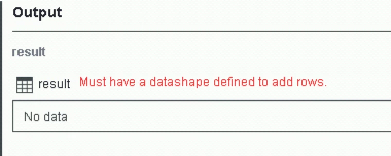

Hi there,
We recently upgraded to TW 8.4.3 besides that we have had a "hell of time" and not funny way.
I have stumbled upon something that bugs me.
I was use to when service with defined output as string failed an error message from exception appeared in result window.
No there is this weird message "Must have a datashape defined to add rows."
I handle most of my services with try-catch, but not always printing the error part in logs.
This is very difficult to debug.
What is with that, is this by design? Can it be solved?

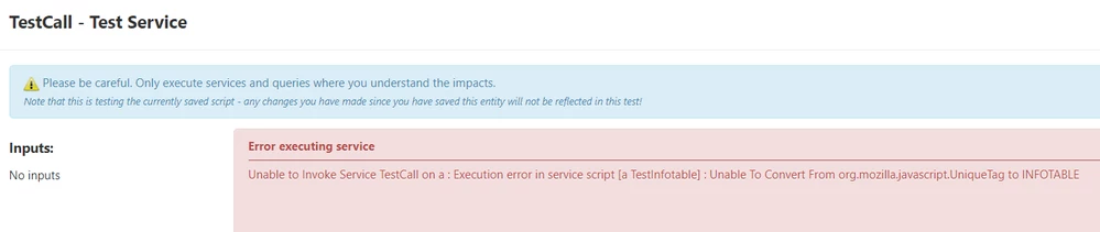

Now let's consider Infotables and change return value type of ExampleA to INFOTABLE. Two options are possible:
Option One is when you made a typo or simply forgot to declare result variable. You already know what happens in this case -- the service will try to return an undefined, which does not exist natively in Java, this value will be wrapped into a UniqueTag literal object, and everything else will fail, because it will be trying to cast it to Infotable, which it isn't. Take a look at the attached screenshot, I'm sure you've seen it before:
In Option Two you declared result variable, but did not initialize it. Then the service will return... No, you're wrong. An empty Infotable without a data shape, which is essentially a half-cooked Infotable. The latter is a crucial detail, because what happens next is really hard to predict. For example, you can't AddRow to it, and it won't display correctly in Composer. The real problem is that some of those weird side effects will happen down the road (maybe you'll never even realize that you have an issue). We had some sleepless nights debugging and subsequently refactoring such cases.
...All of which brought us to a simple conclusion / best practice: Always initialize your variables as explicitly as possible. If a service is supposed to return an Infotable -- preinitialize result variable with a proper empty Infotable. Same for the strings. If you need to return a number -- return -1 by default, etc. If you really have to return an empty value, then return null explicitly -- this should minimize amount of type conversions that Rhino and ThingWorx will try to do for you. Finally, if there are exception thrown -- don't catch them until strictly necessary, to make sure that those empty values do not proliferate throughout your runtime.

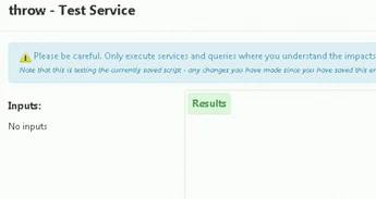

tcoufal1-VisitorAuthor
July 24, 2019

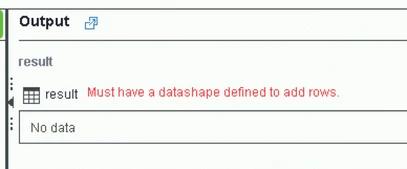

I found that this error appears when there is a result var declared but has no value.
I made a service containing only:
var result;
in 7.3.4 result window contains nothing but it is green
in 8.4.3 there is this message I dont like
Snímek obrazovky 2019-07-24 v 10.19.26.pngSnímek obrazovky 2019-07-24 v 10.19.08.png
18-Opal
July 24, 2019
This error message is displayed by the Composer, which (I guess) tries to display Data Shape name for returned values and fails because it is undefined. The actual service behavior is the same as in 7.4, it's just the Composer which is different. In other words, your code which uses this service shouldn't be affected. The question of whether or not it is an actual error situation deserves...
