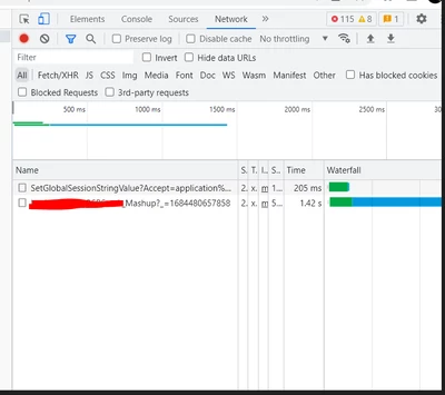

Hi Folks,
I have a requirement to show some loading message/gif before the mashup loads. I have tabs selection with lazy loading which takes some time to load the content (expected) once a tab is selected and want to show loading message/gif between this tab click and content load and message disappears once the Mashup load event is completed. But I don't see any event/service to trigger this message display before the mashup load. I can see SetGlobalSessionStringValue being invoked but that's an internal resources call and not part of Mashup design.
Any idea?
TIA.

I know how to put a loading indicator for the long service execution. My query is little different here.
I want to trigger the popup or whatever the placeholder is, before the mashup load event. once the mashup loads I don't have any long running services but mashup load itself takes sometime due to lazy loading.I believe that's not possible but still want to check if something can be done at platform level.
