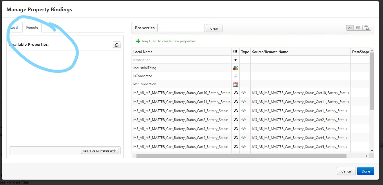

No Kepware tags using remote bindings.
I've been trying to connect some kepware tags using remote bindings in the properties section of the thing I have created. I can see that kepware is connecting, but for some reason when I click on remote bindings it is just blank, no error, just blank. However, when I click on new composer and use the discovery option, the channels and kepware tags appear and I can bind them. What would be the reason for this discrepancy?

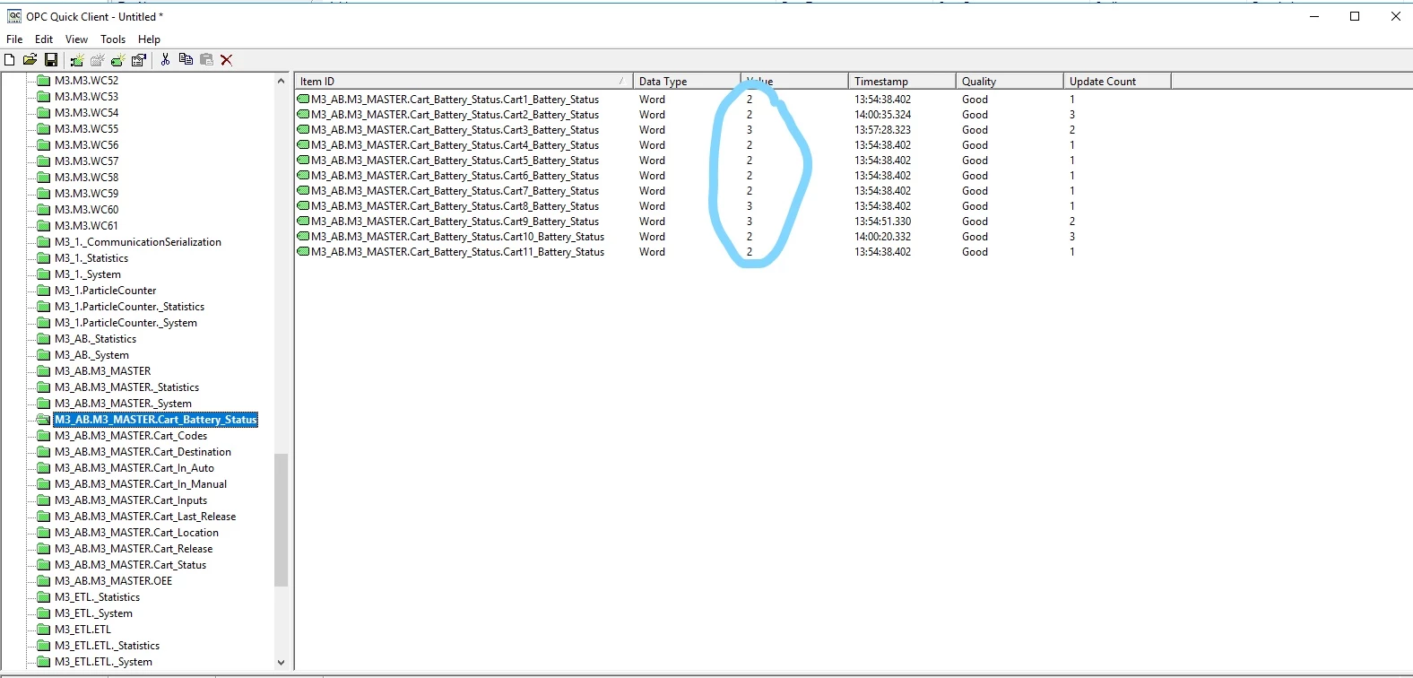

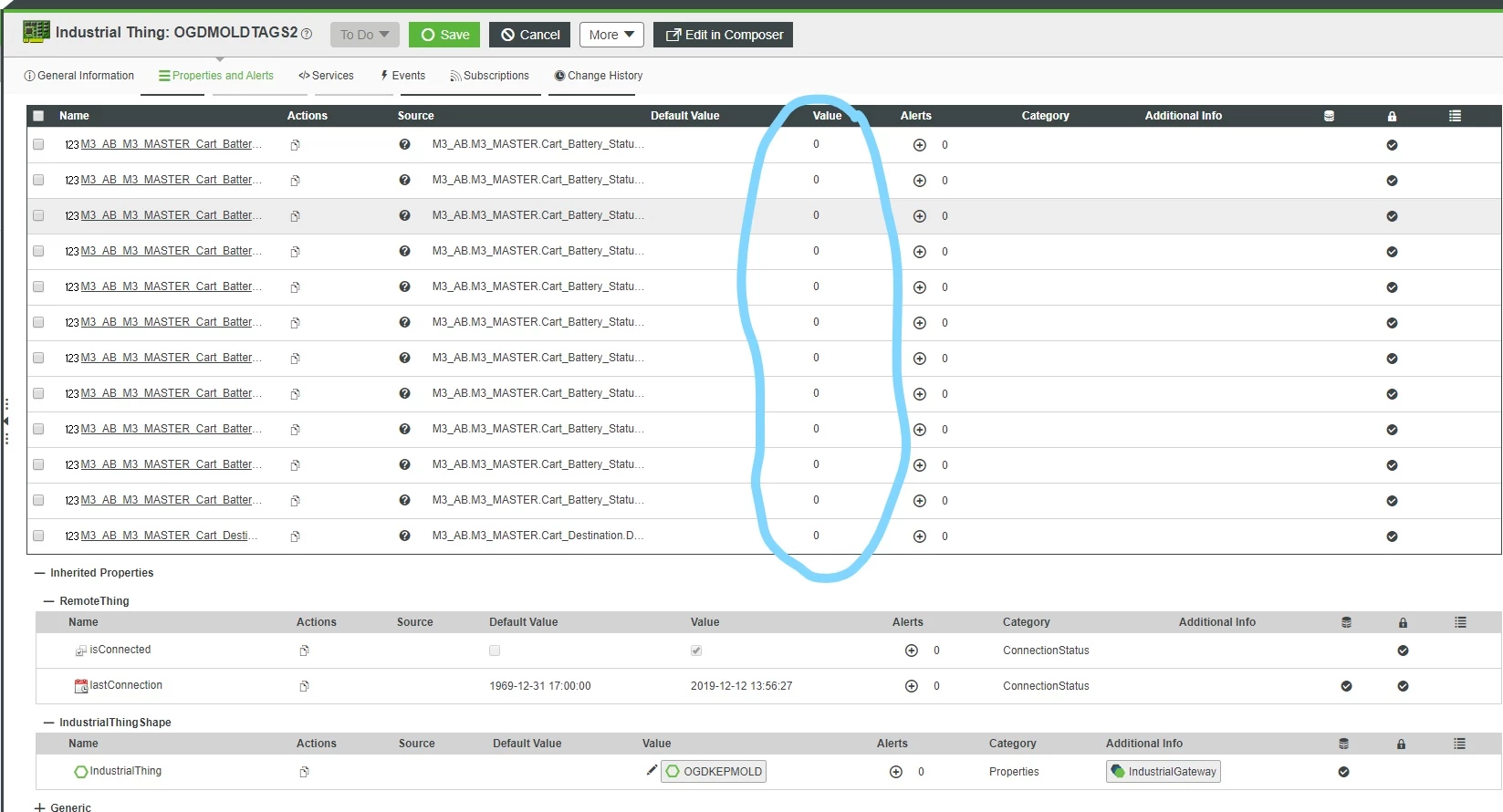

Also, after I've used discovery to find the tags and bind them to my Thing, I click refresh and there is no update to the value, they all just stay zero. When I examine the tags using kepware, the values are all correct. What am I missing here?

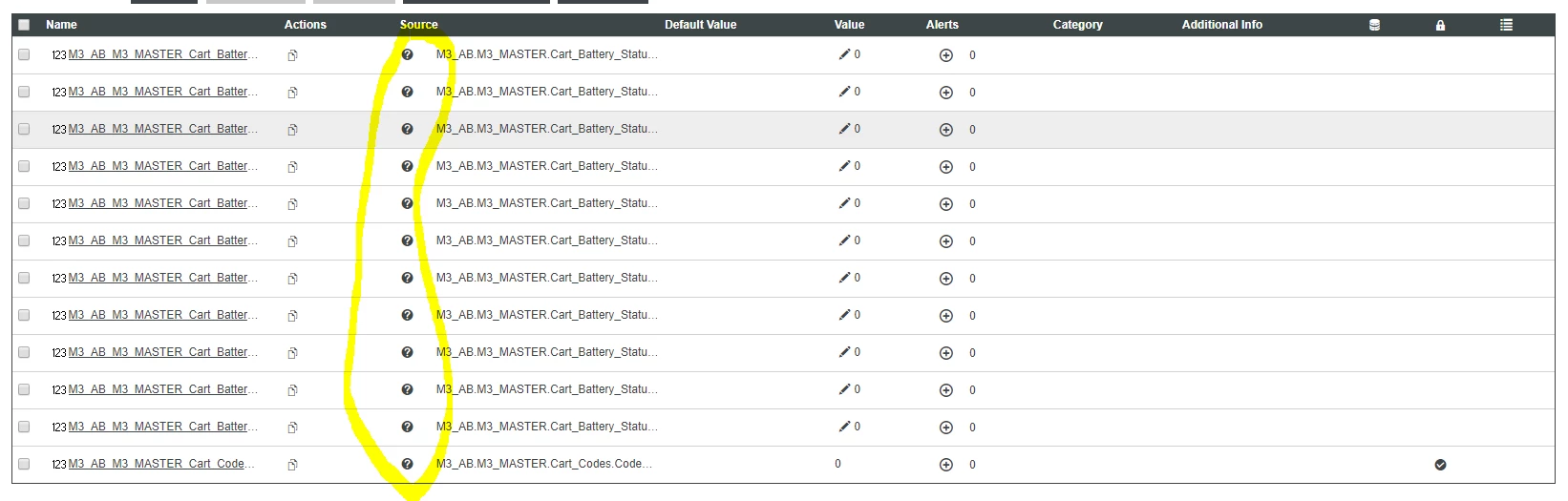

For some reason I can't get to the debug in Thingworx, but I can attach the event log from Kepware. I don't see any errors, but give it a look maybe there's something I'm missing. Also, I noticed that the quality of my tags is unknown. I've tried reinitializing  and restarting the kepware server, but the quality remains unknown.

Can you capture a screenshot of the Remotely Bound Property settings for one of the affected "unknown value" properties? The only expected scenario where a connection is formed between Kepware and ThingWorx and properties are shown as unknown is when the Remotely Bound Property is set to Never Push. In this scenario Kepware does not push updates to the property and an action on the Platform must force the value to be read from Kepware.

Following our case we have concluded this issue was due to permissions associated with the non-administrator application key used by KEPServerEX to access the ThingWorx Platform. Permissions noted in CS311909 must granted or an administrator application key must be used (not recommended in Production).
As we have now determined the root cause please accept this as a solution when possible.
