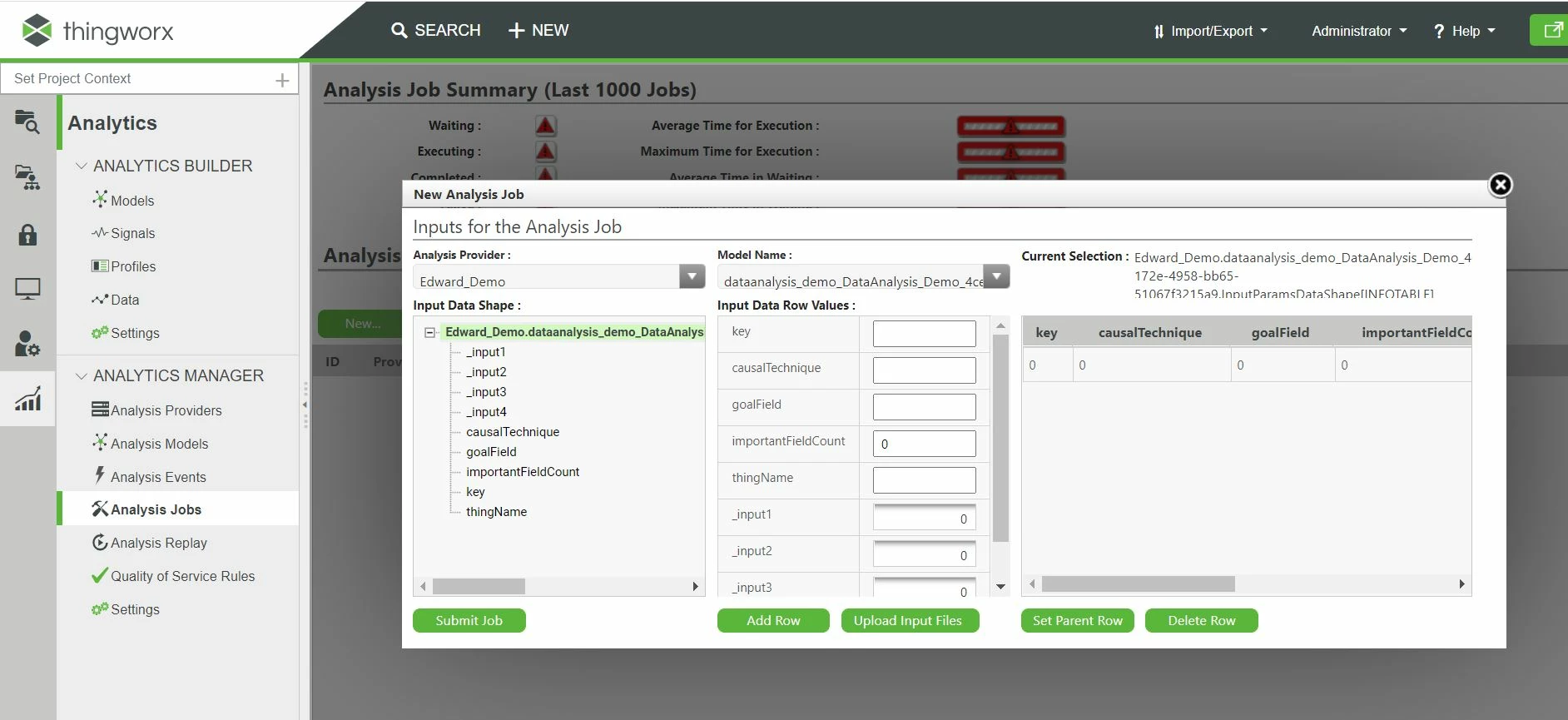

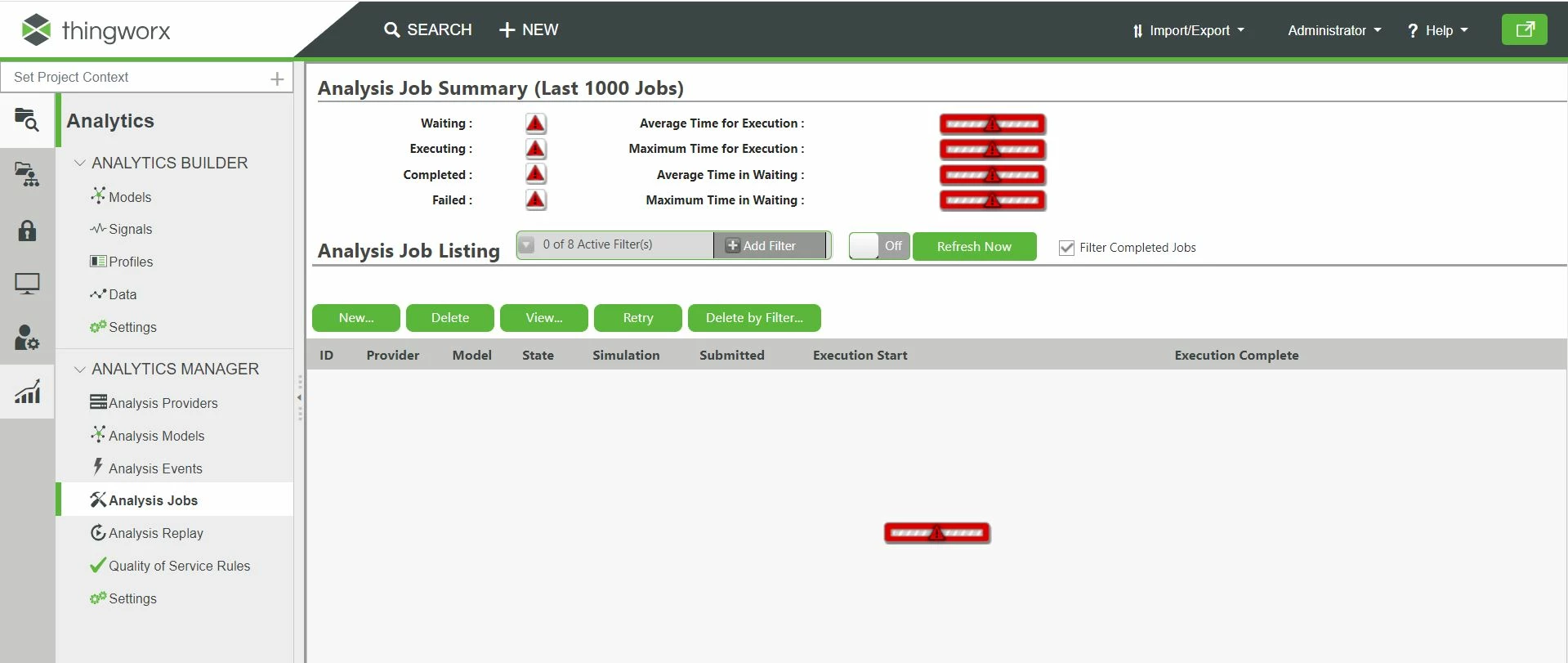

Has this probelm been solved? I probably meet the same problem. The Analysis Jobs cannot work any more but other modules of Analytics are all OK. we donnot know how to solve this probelm. we will appreciate it if you have some good ideas.

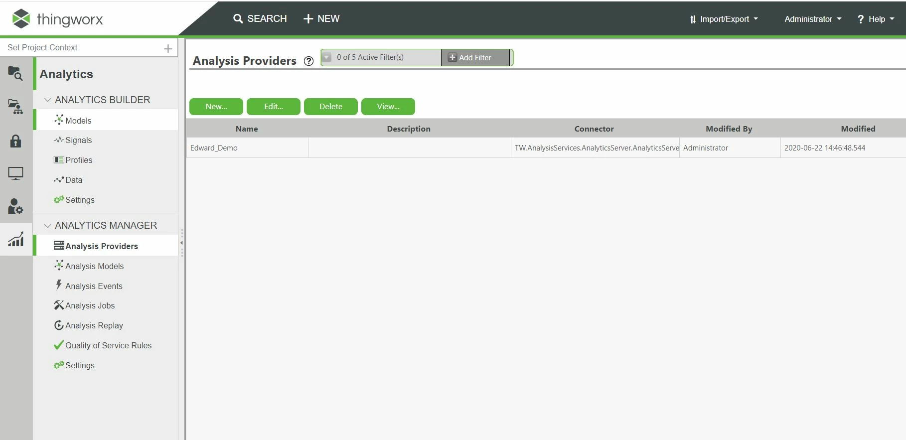

Have you also verified that the provider you are using is connected?
Here is the 8.5 HelpCenter link with information around Analysis Providers and connectivity: http://support.ptc.com/help/thingworx_hc/thingworx_analytics_8/#page/analytics%2FAnalysisServices_WorkingWithProviders.html%23

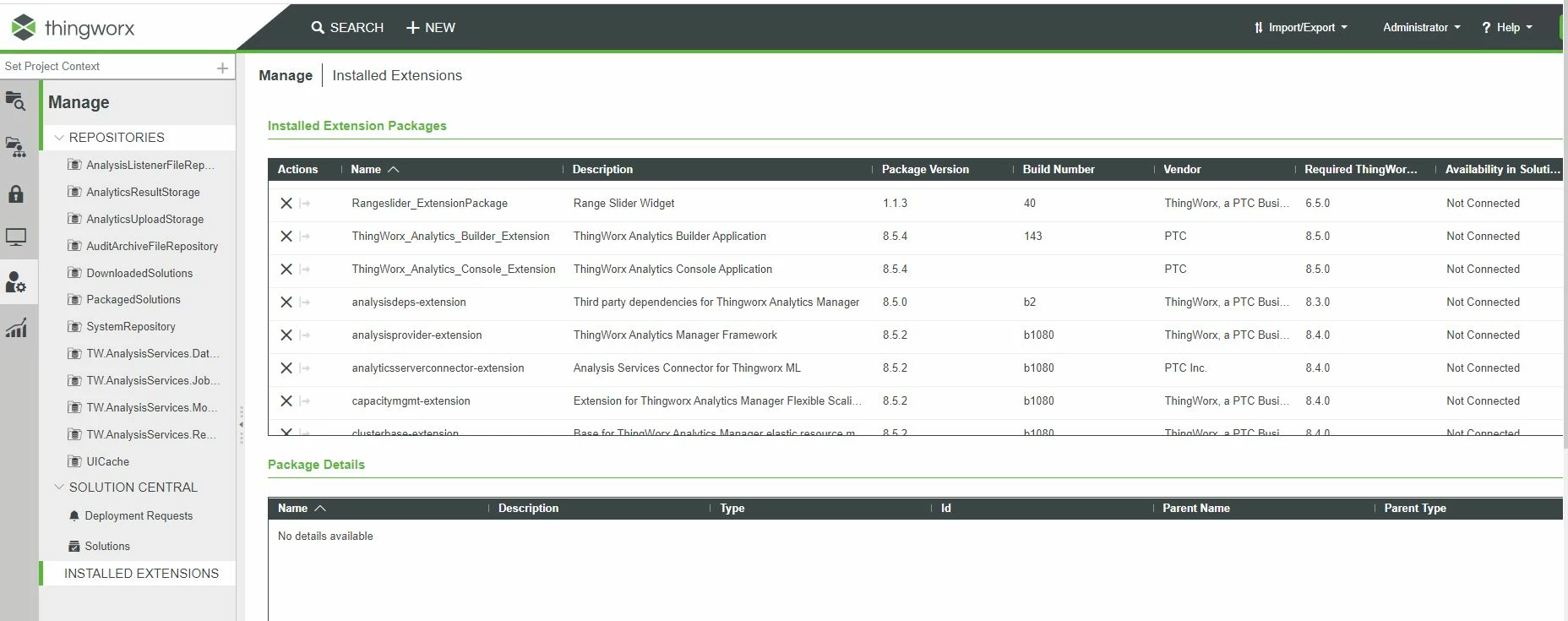

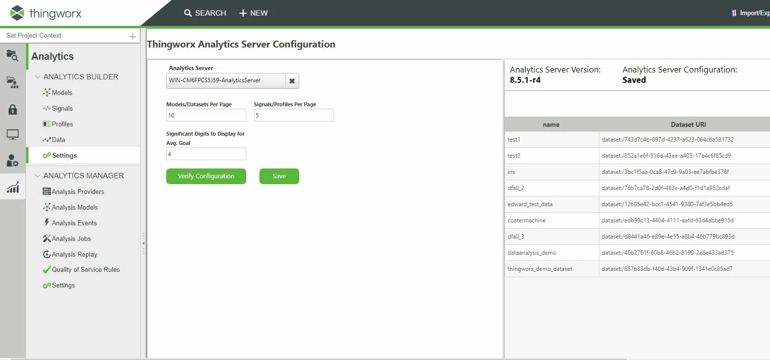

Thanks for your reply. The version used are as following:
ThingWorx 8.5.5-b103
Analytics Server Version: 8.5.1-r4
Analytics Builder extension: 8.5.4
Analytics Console extension: 8.5.4
After the model has been built,  we try to build a job in Analytics job, there is no reaction after click submit button. And the page of Ananlytics job are always excalmatory mark these days.
Our Ananlytics extension works well in the past weeks, as we have used the Ananlytics job to do some demos. However, we don't how it happens at present.
Thanks for your assistance.

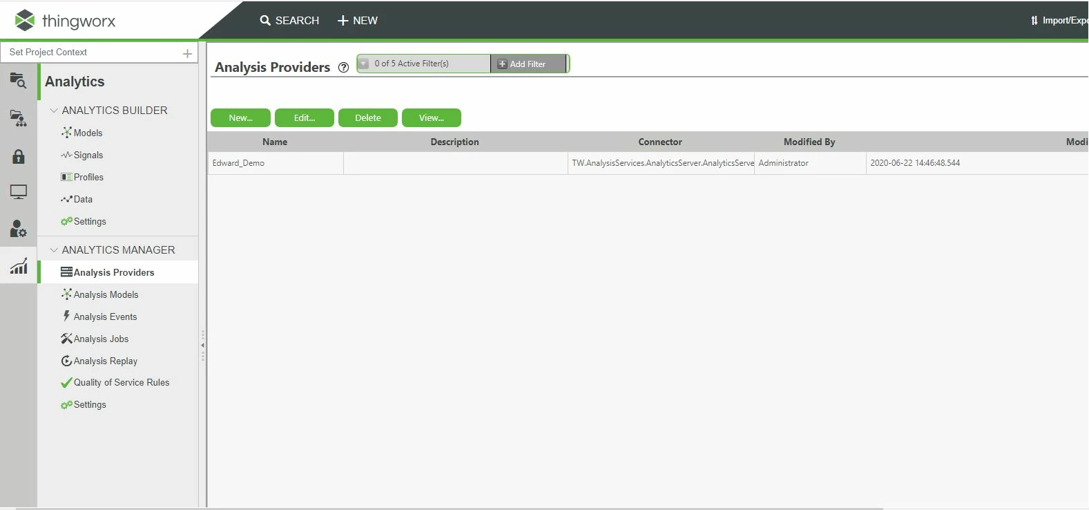

Thank you for that information. Have you reviewed your Analysis Providers in Analytics Manager? As in verify that it is connect by doing the following: click on the Provider, then View, then Connected Clients?
Did you review the logs I indicated? Application Log, Communication Log
In order to assist you further, I would require your feedback on those questions.
