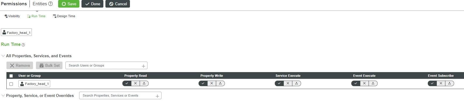

I have created the organization, group, and user(user: Factory_head_1) for my project and I have added the user to the group and given all the permissions at the organization level, group level, and as well as user-level.
I am able to login successfully and can view the mashup.
but not able to view the service data.
I have created a Thing(Thing name:507)and  2 services called Live_json_data and GetAlerts.

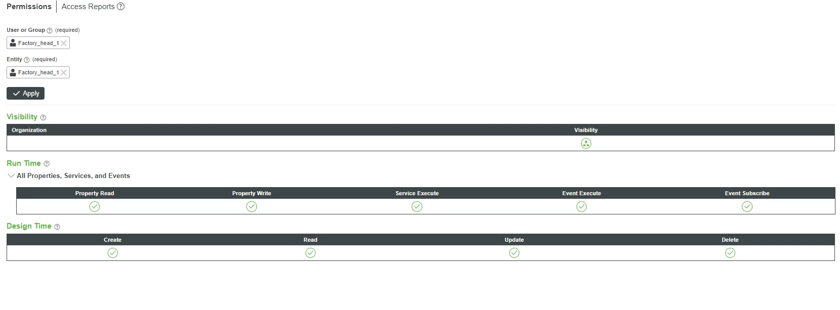

I have also attached the access report with the same please refer attachment

I checked your screenshot again, the permission target entity is the user itself, not the Thing entity with the services you need.
Hi , when you're configuring the permission for a mashup, here is what to do:
1. open the composer with Admin user (so it's easy to edit the permission)
2. open the mashup with the custom user in incognito mode (so we can check what's missing by using F12-Network in the browser)
3. From the browser console (F12-Network), when you see 404, it means Organization visibility is not granted, if it's 401, then it's runtime permission missing, Configure and save in the composer, and refresh the incognito page to check again if it's fixed
