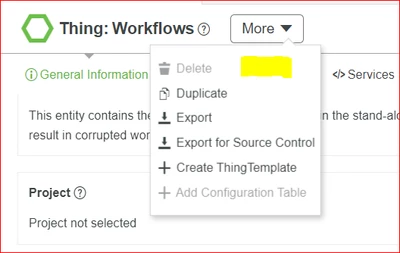

Hi Folks,
I'm trying to delete a Thing which is not a system object actually but whenever I try to delete it using "DeleteThing" service, getting error "cannot delete a system object"
Its XML configuration has tags as follows:
<aspect.isSystemObject="false" aspect.isExtension="true">
Any suggestions?
zyuan1Answer
September 10, 2020
Hi, this Workflows Thing is a system object, connecting TWX server to TWX flow (Synphony) introduced after 8.4. If you want to remove this entity, you need to uninstall the Flow first.
When you are trying to remove entities, you can always see warnings if you failed to do so.

TanmeyTWX17-PeridotAuthor
August 28, 2020
Hi Teresa,
If you meant "Delete" option in the UI itself then not possible. Because thing is already in a non-editable mode.
